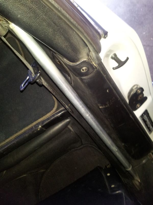

Answer is yes, but all combined with upped T-bars, Sways and Front Strut Bar, believe it or not the Targa Body Brace really completed my set up.
Had a well respected Pelican drive my car before and after and he was genuinely surprised at the day and night handling. He was quite skeptical, he wanted in his cab but, then he realized it was a no go so he opted for a roll bar.

I have the Targa bars installed. I just restored and finished installing a factory hardtop tonight.
Should be tight and water tight for the winter, no flex in the hard top...
Suspension refurb is next. Ball joints, turbo tie rods, bearings, all rubber bits etc. are sitting on the shelf.
