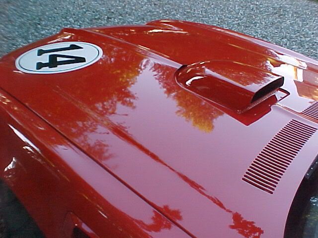

Posts: 19,644
or this:
Note the air ducts on the side of the engine lids/spoilers.

You could put a "cold" air intake outside of the engine bay- where the GT2 scoops are and get cooler air than in the engine bay.
There is a small amount of "ram air" in any forward facing scoop- but the compression is not significant until high speeds.
NACA ducts are the best at reducing the compression of the incoming air in order to reduce drag on high speed airplanes.
