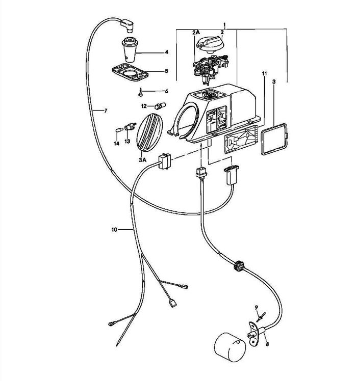

Could somebody please help me shed some light:
The cable for my interior temp sensor ('82 SC) has been cut by a PO. I may have found a spare at a breakers, but it's from a Targa. Where is the sensor located in a Targa? It seems less-than-perfect to have it by the sunvisors in an open-top car. Does anybody know if the cable is the same for a Coupe and a Targa, regardless of location?
To clarify, it's the #7 cable I'm wondering about.

99% sure that there was only one cable to that sensor, until they moved the sensor location in 1986.

I have a 85 Targa with auto heat. The sensor is between the sun visors.

Terrific, that's the answer I was hoping for. Thank you both for your help!
