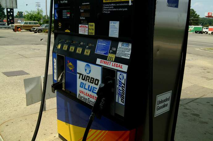

You need to come to Michigan to buy your fuel! Many Sunoco stations have a special little pump tucked away in a corner:
-- Curt

Curt, what's the price-per-gallon on that 101 octane?!?

I think it's around $3/gal. The funny part is the "Street Legal" sticker on the pump. If you read the fine print on the white sticker just above the "101" sticker, it says something like 'this fuel is for off-road vehicles only!' -- Curt

curt, i notice in that photo that the 101 pump is in its rack and the other pump is 'being used.' what gives?

Well, there are benefits to running 7.5:1 RS pistons - 87 octane fuel being one of them! -- Curt
