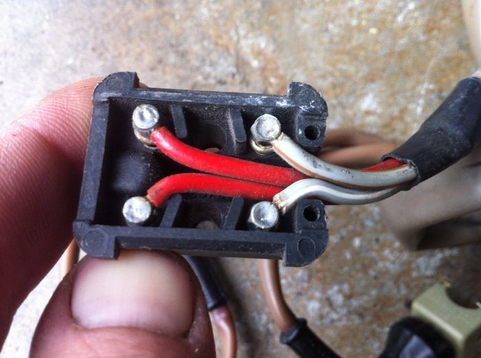

Ed (or anyone else),
Any idea what these wires are for? Two heavy gauge yellow and two red with female pin receivers, clustered together toward the back of he engine bay. Could this be related to AC components? I haven't seen any reference to these in the other conversion/transplant posts.
Thanks.
Roger

E Sully 04-11-2013 11:20 AM
Hard to say since I sold my engine and harness, but could be part of the connector to the engine fuel injector connector. Mine was by the shock tower. Nothing to do with A/C, Grn and Grn/Y to the DME are the only A/C connections in that harness.

Roger 911 04-11-2013 12:21 PM
Thanks Ed. The one thing that seems strange though, is that this is a group of only 4 wires. It would seem like if it were for the injectors, there would be 6. Also, the gauge seems pretty heavy (maybe 14?). This would seem to imply some sort of high current application. I didn't think the injectors drew that much current.

LJ851 04-11-2013 01:07 PM
I'll look around the engine itself and see what I can find. I have the Bentley manual, so I should be able to find it in there (just takes forever).
Roger
Looks like the chassis side of the fuel injector connector. It is missing it's brown case that makes it a connector.
The 3.2 injectors are batch fired, the fuel injector plug is indeed 4 heavy gauge wires.
Roger 911 04-11-2013 02:58 PM
This is helpful. Apparently when they removed the wiring harness they lost/damaged the housing for these four. That may make it a little more difficult to match up with the male plug. I suppose these must correspond to pins on the DME end, so if all else fails, I can identify them by running current through them and finding the corresponding pin at the DME harness end.

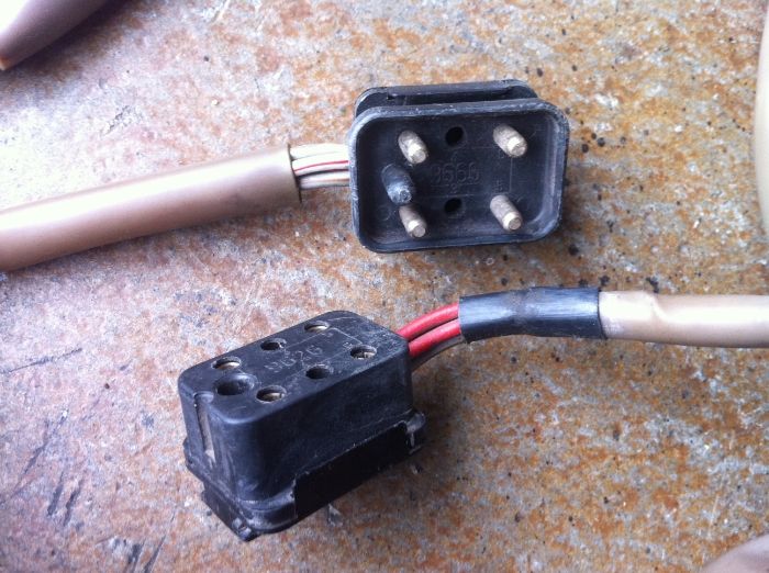

Roger, I took a couple pics of a '86 3.2 harness i have.
This is of the male and female fuel injection plugs.
http://i1178.photobucket.com/albums/...ps214e065a.jpg
This is the back of the chassis side (female) plug with the cover removed.
http://i1178.photobucket.com/albums/...psaf380445.jpg

Roger 911 04-11-2013 07:03 PM
Got it! Thank you. of course if I had taken a second to look at the engine before I posted, I would have seen the plug right on top. I do appreciate the help.
