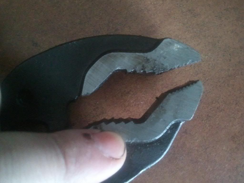

I win.
http://i225.photobucket.com/albums/d...85870404_n.jpg
NO DAMAGE to the sealing surface OR the tank, but the tank had to come out.
I realize some of you may think rage faces are "silly" but this is pretty much how I felt after I got it out.

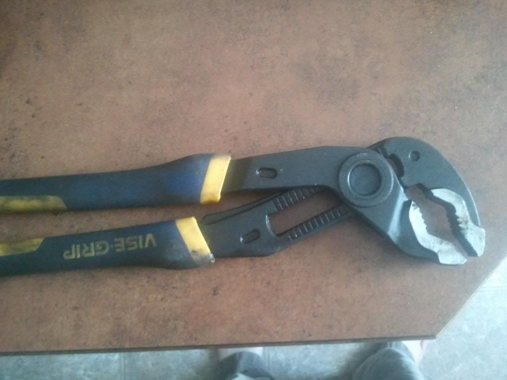

CorsePerVita 04-10-2013 01:35 PM
Originally Posted by KTL (Post 7379201)
I was going to say you need to embrace the masses and take the advice of vice grips or a pipe wrench, as they are your best bet. Glad to see you've gotten it off! :D
For future reference, people gotta embrace the pipe wrench. It's the baddest SOB in town when it comes to grip. Vice grips ain't got jack on Mr. Pipe Wrench. Vise grips only grip as well as the teeth can bite, and that's dependent on your kung fu grip strength. Meaning, how strong is your hand's grip, which determines how much "load" you can put into the vise grip. I consider myself stronger than the average guy and I can really load up a pair of vise grips. Once loaded, those suckers grip pretty good. And they also have a lot of stored energy to jack you up like Norm mentioned. I hate it when vice grips jump off and pistolwhip you........
Pipe wrench is all about how much force you can apply to it. Put a length of pipe on a pipe wrench handle and you can impart some MASSIVE grip on most anything. Think about it. A pipe wrench is specifically designed to grab smooth round things- HARD. The harder you push, the harder it bites. As long as you get the wrench snugly fitted around the offending piece (wiggle the head as you tighten the collar to get it nice & snug), you're going to get a good grip. Even on a small surface like the drain plug.
As an aside, I recently disassembled a Porsche oil cooler t-stat. Those stupid slotted caps....... What genious decided a screwdriver-like slot on such a large cap is a suitable tooling? :mad: Anyway, the winning tool was Mr. Pipe Wrench. Mangled the caps pretty good but I got 'em off. Nothing else was going to work. The fix will be to weld some aluminum bar stock (hex shape) to make the caps more serviceable.
These were actually some vice grips. But when I looked at them, instead of being like normal vice grips where the teeth were straight down, these are hooked backwards so when you go to remove something it actually bites into them like an extractor. Tough SOBs. Found them at Lowes.
Nice thing is... instead of having to grab both handles, I can put all the force on the longest handle for leverage and due to the way it bites down, I was able to apply all the force there and "POP" it came right out.
http://i225.photobucket.com/albums/d...4-10143014.jpg
http://i225.photobucket.com/albums/d...4-10143028.jpg

Question for inquiring minds: What size of this "vice grip" tool did you use?
porschenut 04-10-2013 03:29 PM
I thought the shop agreed to do it for you. Change of plan?
CorsePerVita 04-10-2013 03:52 PM
I spelled it incorrectly, "Vise-Grip" made by Irwin tools. Got it at Lowes. Exact part # is 2078112. 12" version.
http://www.amazon.com/Irwin-Industrial-2078112-12-Inch-GrooveLock/dp/B000A0WM2E
They sent me another email last night to "bring it in and we'll look at it" and that it was all due to my "inexperience" - that was from the shop owner. So it seems to be I would have been back to the start. I figured I'd give it one last shot. I figured at this point, it sounded like since they wanted to be flip flop on whether or not they'd "fix it" or "fix it at a price" I'd go ahead and just see if I could get it. So I did.
