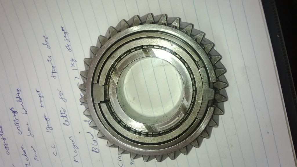

So my mechanic rebuilt the gearbox and it still grinds. It grinds going into second from first unless I pull it as hard left as possible, then sometimes it doesn't grind but again it takes a long time to slot it in. From third to second it grinds no matter what. This only seems to happen with second gear.
Three servo pieces should be installed under the synchro ring- a circular band, an energizer and anchor block. I don't see them in your pictures of damaged parts. If any or all of these pieces were not replaced, your synchro will not function properly. You might review your receipt of parts purchased, and check what damaged parts were not re-used.

We only put in a circular band, I don't remember an 'energizer' or anchor block.
Any idea what these look like?
Since I'm going to UK this coming week I can pick up these parts.
Thanks for the heads up!

Ok so the ring was installed but not the other 2 smaller parts.
Oddly enough the mechanic never mentioned those parts and I don't remember seeing them.
He just brought the broken ring and said buy this.
I'll have to ask him before confirming to make doubly sure but that looks like it would confirm the terrible gearchange.
Thanks guys, it always amazes me how someone 10,000 miles away can help me out!

Be aware of all the synchromesh pieces on the gear:
*The synchro hub (toothed ring pressed onto the gear)
*The synchro ring
*The circlip (retaining ring)
*The circular brake band (upper photo)
*The energizer (small block with tab, upper photo)
*The anchor block (small wedge piece, upper photo)
There are 4 pieces which might be described as a "ring".

faiz 12-19-2013 12:50 AM
I can do that sort of work, I just don't know anything about the internals of gearboxes.
So all the parts are in the box;
http://i272.photobucket.com/albums/j...psacb13d09.jpg
Any other ideas?
Perhaps an adjustment issue?
Any help would be great, engines dropped and gearbox is out right now.
EDIT: I guess my mechanic isn't as bad as I thought, feel bit bad now.lol
