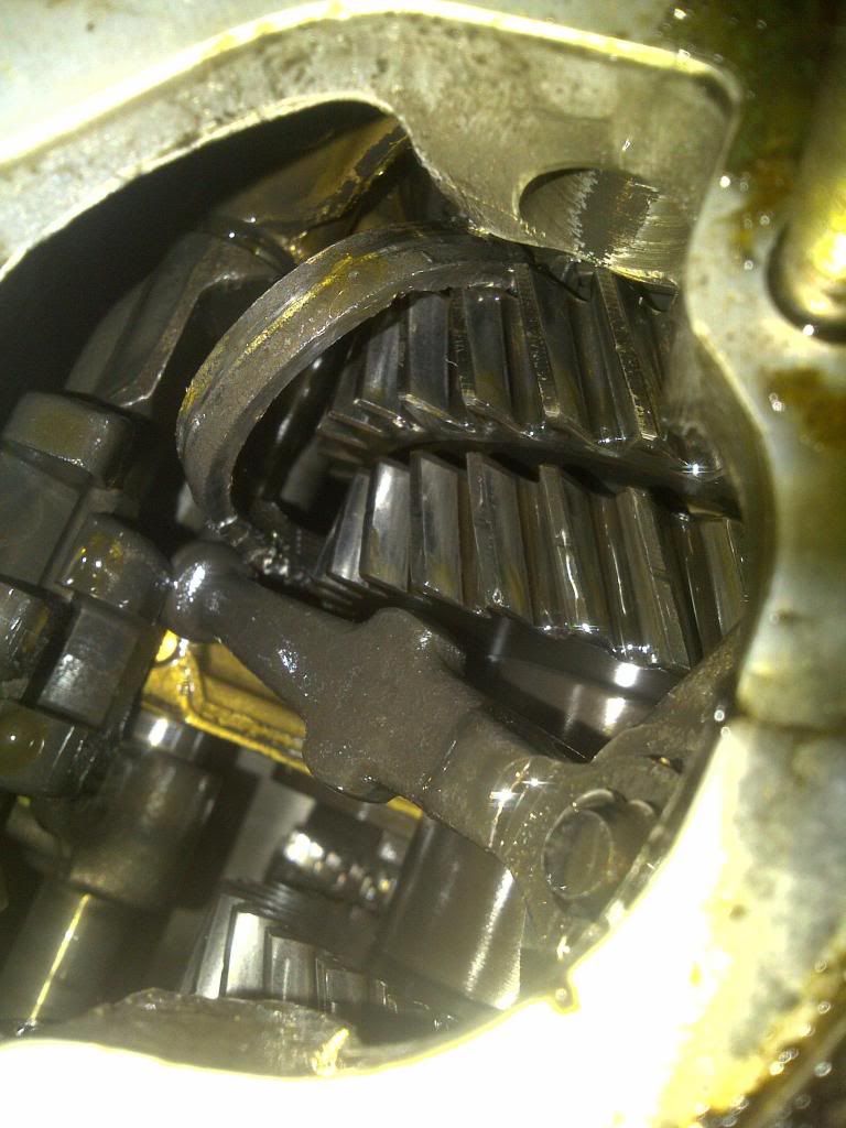

Well I discovered the problem/problems.
This is what I was hoping to see;
This is what I saw;
Totally messed.
Any ideas?
I'm gonna have to drop the gearbox and rebuild it.
What a pain in the a**!
I'm gonna have to drop the gearbox and find out all the parts required and then bring them from england.
So bummed out about this.
No classic car show for me this year as the Karmann is in the bodyshop.
Have you guys ever experienced this before?

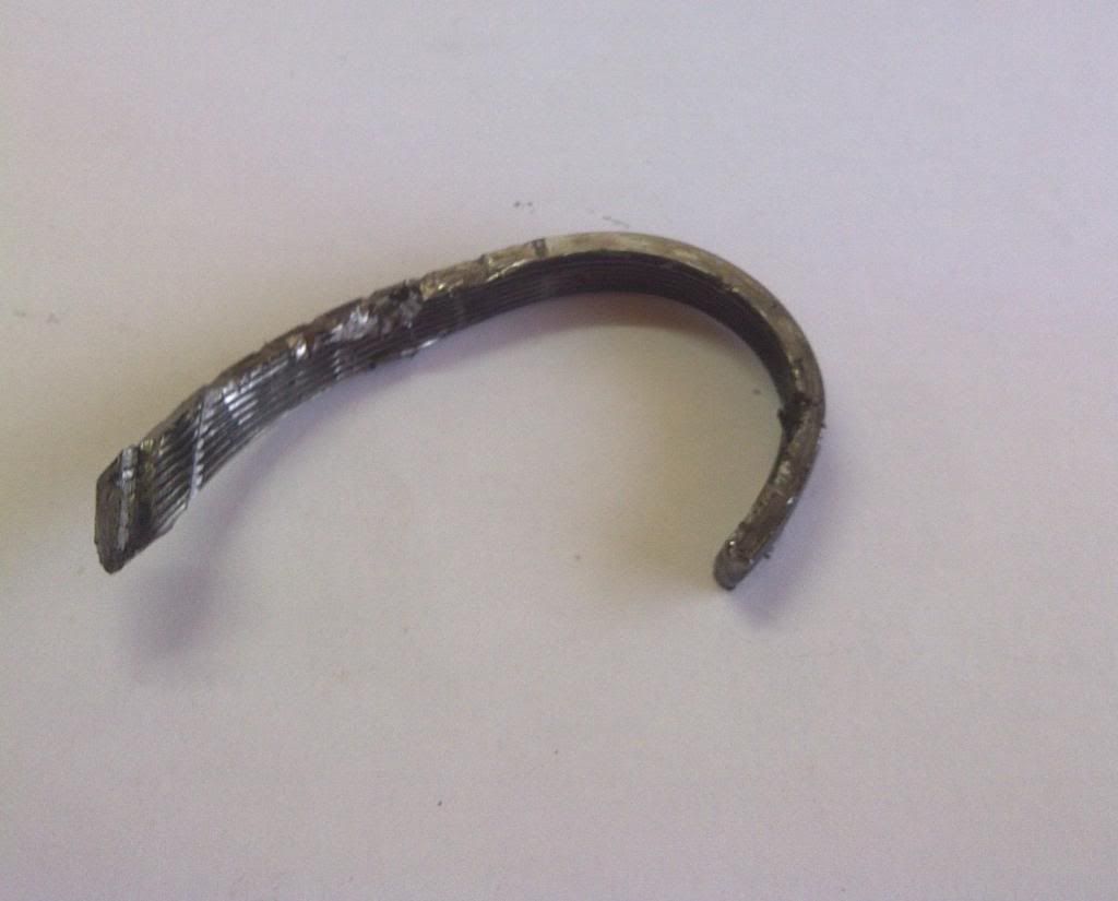

ewww.... that's a complete disintegration of a selection gear. That big chunk out of place is a syncho band. That seems really odd to blow up just driving down the street. It must be in multiple pieces. I'm surprised you didn't break the main shaft either!
Yup, pull the box and begin your journey... sorry

Yep, see it more often that most people around here think. What happened is the circlip that holds the synchro onto the gear let the synchro out. Sometimes you get away with minimal damage. Sometimes the pieces go through several gears, destroying them. Won't know until you get it apart.

or the teeth broke off the dog tooth ring and the syncro stuff exited and left the snap ring in place.

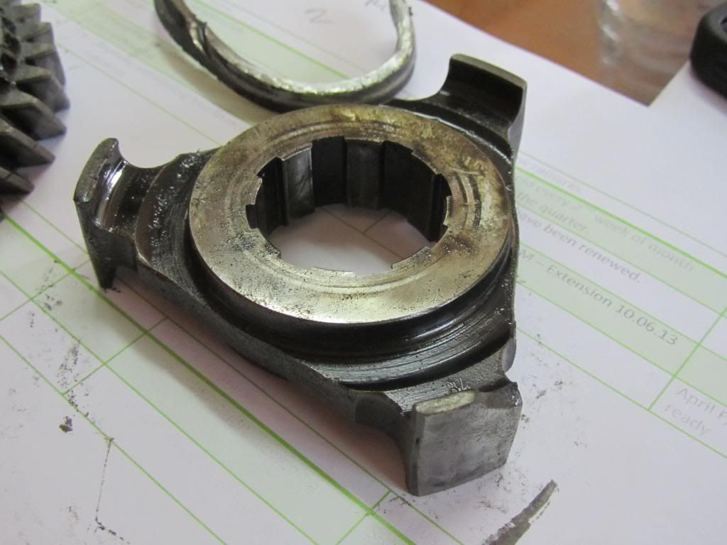

Managed to pull the destroyed synchro band out, most of it anyway;
[/URL]
Putting the selector back in place and then going to try roll it into my garage slowly so I can drop everything.

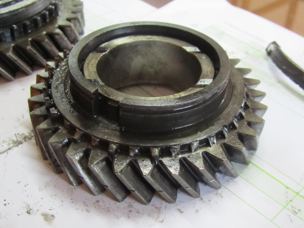

Yup you got it.
Looks like the teeth on the 2nd gear dog tooth snapped off and one synchro ring came out.
Also broke the synchro guide sleeve unfortunately.
So annoying as it's such a minor break.
So it looks like I need to order those 3 parts and a gasket kit only.
Anyone have any advice on other parts to order?
