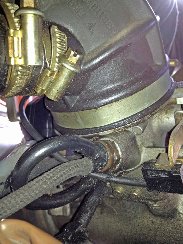

Join Date: Jun 2013
Location: Ireland
Posts: 50
Hi,
I'm not sure if you can see this picture but the blue pipe runs from the upper sensor to the lower port.
The Pipe in the bottom left runs near the oil tank and is blanked.
The other pipe on the sensor is pipes along the right hand manifold and is also blanked with a screw.....
I am absolutely sure that isn't right!!?

You stated:
"I'm not sure if you can see this picture but the blue pipe runs from the upper sensor to the lower port.
The other pipe on the sensor is pipes along the right hand manifold and is also blanked with a screw...?"
While I'm not looking straight at my engine right now, I believe there should be another hose (similar diameter as the blue hose in your picture), that runs to the ambient air valve or recirculating valve depending on what diagram / name you look at. The part number of the valve I have is: 930-207-227-00. The hose that linke the two is 830MM long with p/n 999-239-010-40 Pelican Parts - Automotive Parts and Accessories - Porsche & BMW. Hope that helps.

Would I be right in saying that the one of the pipes runs to the air valve and the other returns? Also, is the function of this valve purely for cold starts and should not affect the running of the car at normal temperatures if it was left disconnected?
I have no idea where this valve is located on the engine or if it was discarded when the engine was fitted (before I owned the car).
If the above is true, are there any side effects to leaving this disconnected?

I don't believe so (at least not exactly). The small hose I have, runs to the top of the air valve - with larger hoses running to oil tank from one side of the valve and to the back / base of the throttle.
In the first attached picture (provided by another Pelicaner) you can see two references to the air valve. Hope it is starting to make a little more sense now.
Am also attaching the vacuum line routing diagram I have - on the right you'll see a line to the Air Valve (that's the part I'm talking about (note the three different lines from it).

In one of your other pictures you showed the back of the throttle with the comment "I'm not sure if you can see this picture but the blue pipe runs from the upper sensor to the lower port. The Pipe in the bottom left runs near the oil tank and is blanked." This blanked pipe is the one that would go to the air valve I'm referring to.
Can you get a better picture of the right side of your engine bay (i.e. the oil tank cap area to see where the small diameter hose is running that comes from the above location?
In the enclosed picture, you can see the air valve above my oil cap. The small tube attaches to the top (from the smaller pipe on the back of the throttle), and the larger tube you refer to above, would fit on the side you don't see.

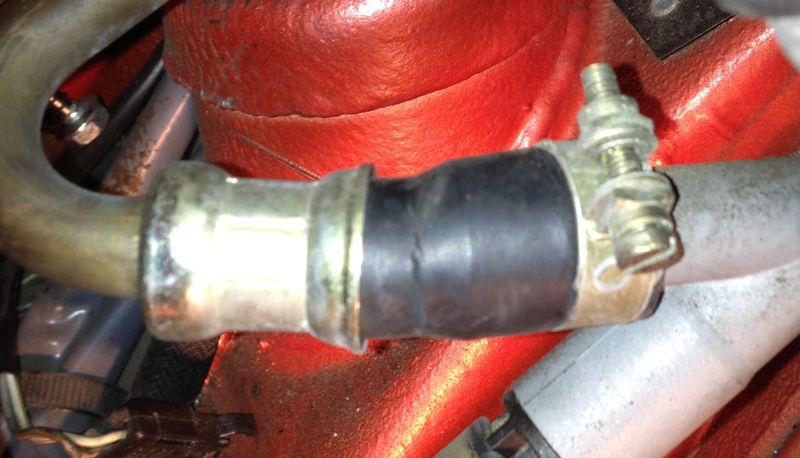

Here's what things should look like back there. As Skip said, the braided hose attaches to the air valve on the oil tank. Mine was found to be disconnected at the throttle body so that may be where the grime there came from. (Engine drop on the to-do list this fall.)
Found this cracked hose during the intake job so we used John Walker's trick and heat-shrinked it.

I also had problems with cracks on the above hose. I cut the hose clamp, got some heavy duty hydraulic hose and drilled one end 15mm and left the other end 12mm. I then used jubilee clips to keep it together.
