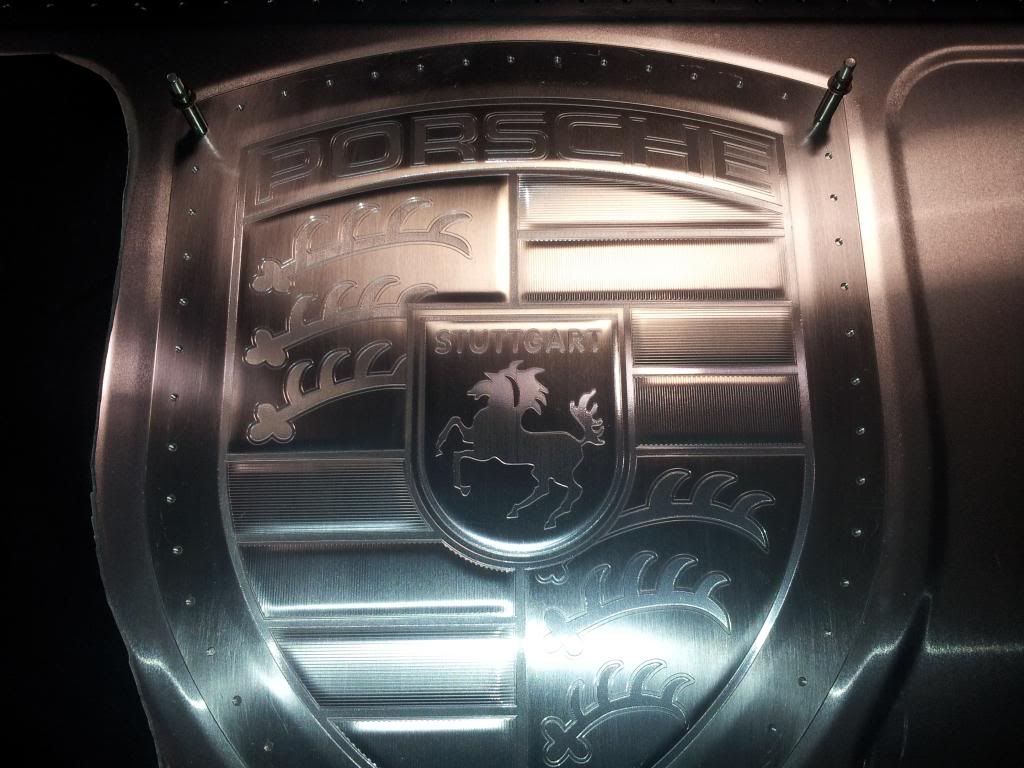

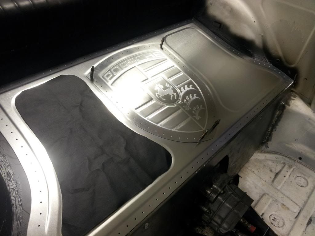

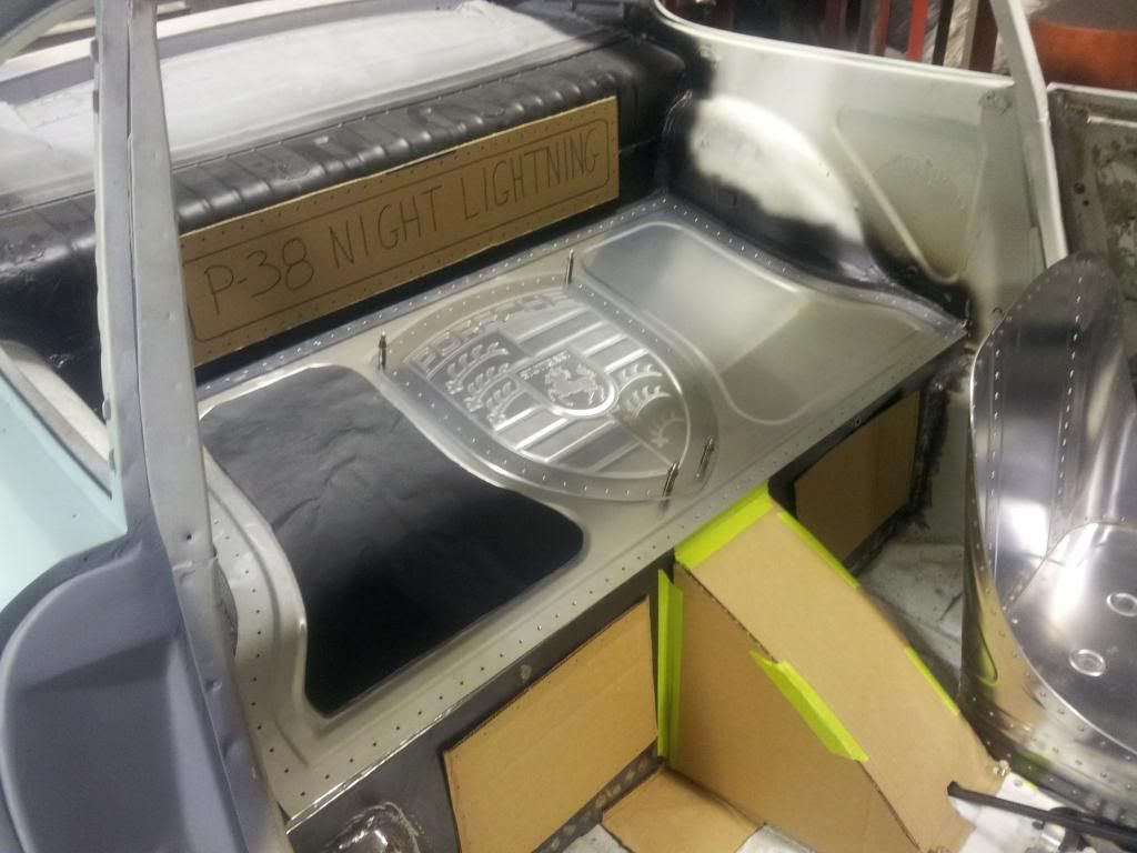

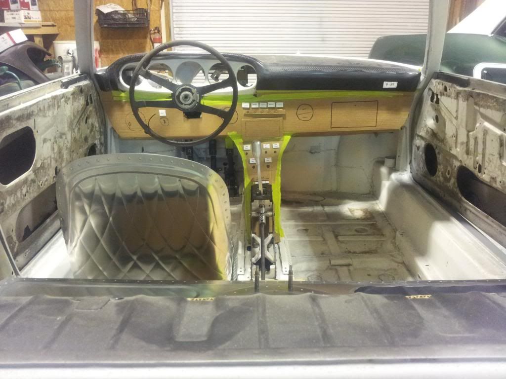

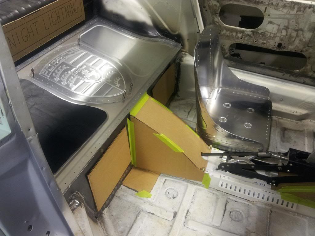

Interior. This is a work in progress and keeps changing here and there. But you can see the overall theme, and there have been a few changes since the picture was taken. BTW, that Porsche logo is entirely hand made and bead rolled. There will be black leather accents on either side of it. Just got one side stuck on to see how it fits.

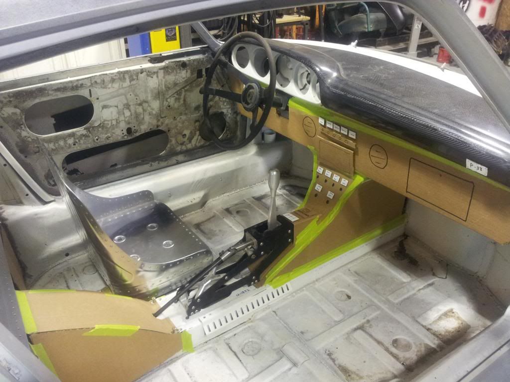

These shots are mock ups in cardboard, and all the front dash stuff will be done in aluminum with tons of rivets, round and oval dimple dies, and such. The stereo system is a DVD head unit with navigation.
This shot shows the Hargett shifter and how it will flow into the front dash, but the rear of it is left exposed.
http://i1365.photobucket.com/albums/...psaccedc03.jpg
We threw that Night Lightning sign in the garbage! It ended up looking cheesy, so we ditched it for a "waterfall" in aluminum that starts at the rear glass and doesn't stop till it hits the floor! Pix to come later on that part.

Close up detail of the engraving and bead rolling.
http://i1365.photobucket.com/albums/...psb791c8d6.jpg
http://i1365.photobucket.com/albums/...ps1877c5eb.jpg

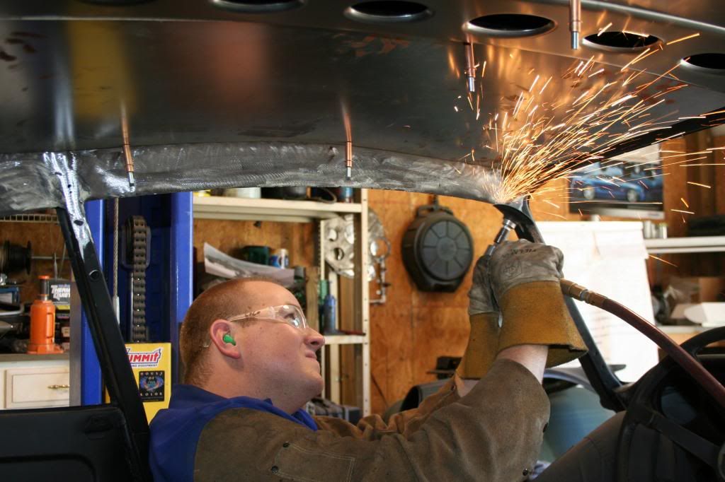

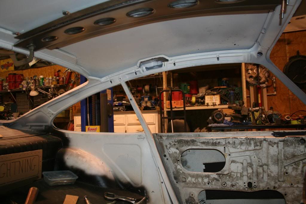

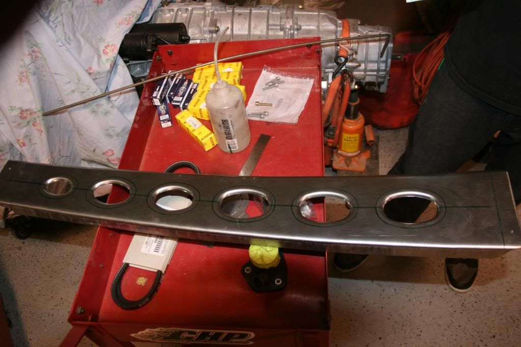

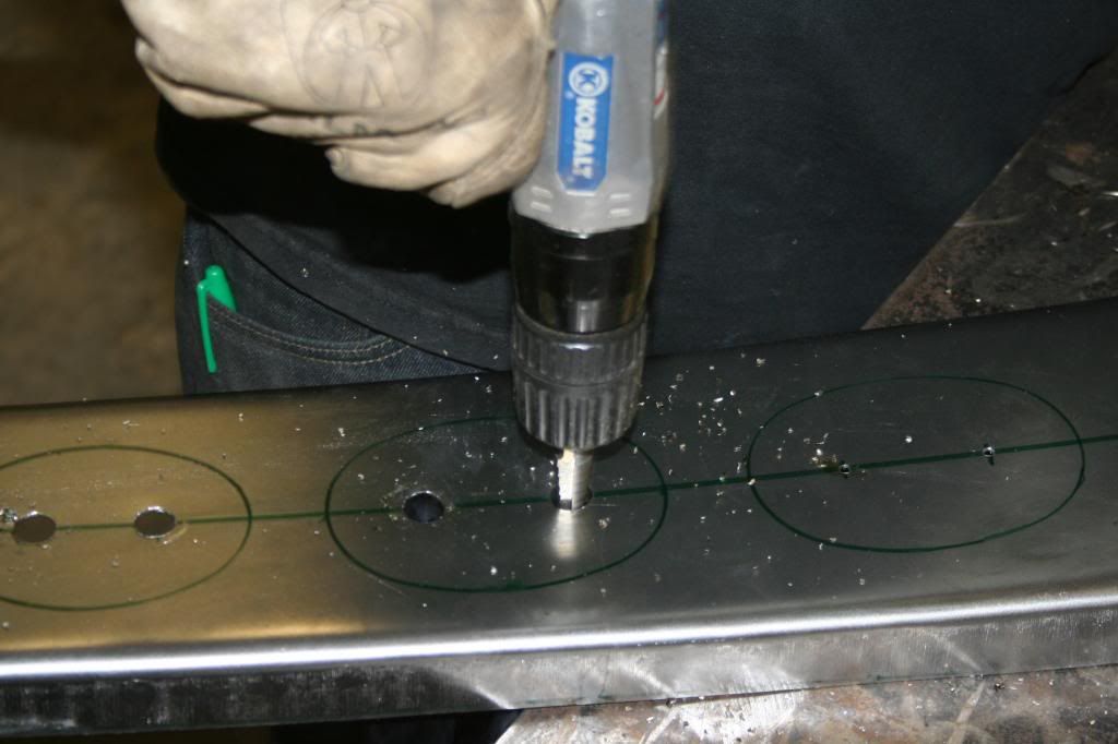

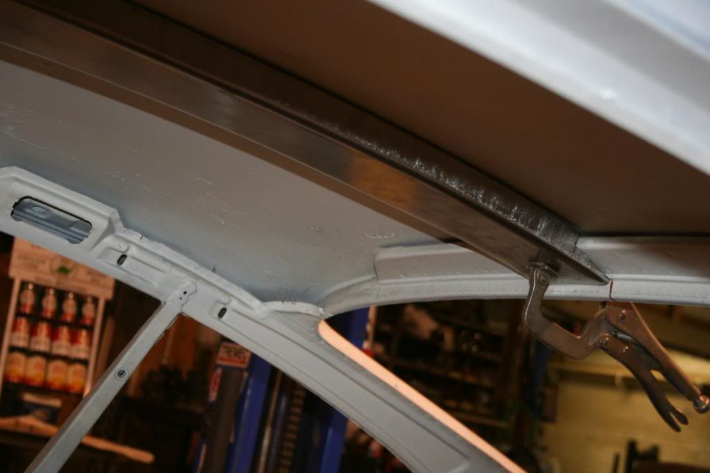

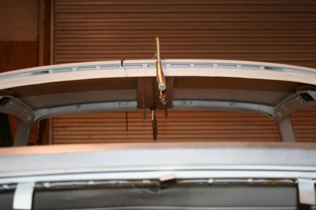

Now to think waaay outside of the box on this next segment. Headliner. There is only so much you can do with a headliner, right? That's what we thought too, but the what-if's start flowing and this is where we are at now.
Started with a center divider that will be welded in.
http://i1365.photobucket.com/albums/...ps4959a560.jpg
http://i1365.photobucket.com/albums/...ps4f5565d1.jpg

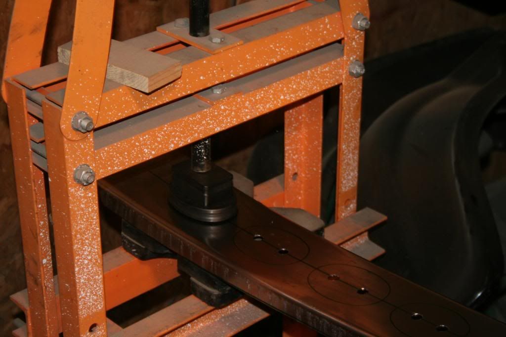

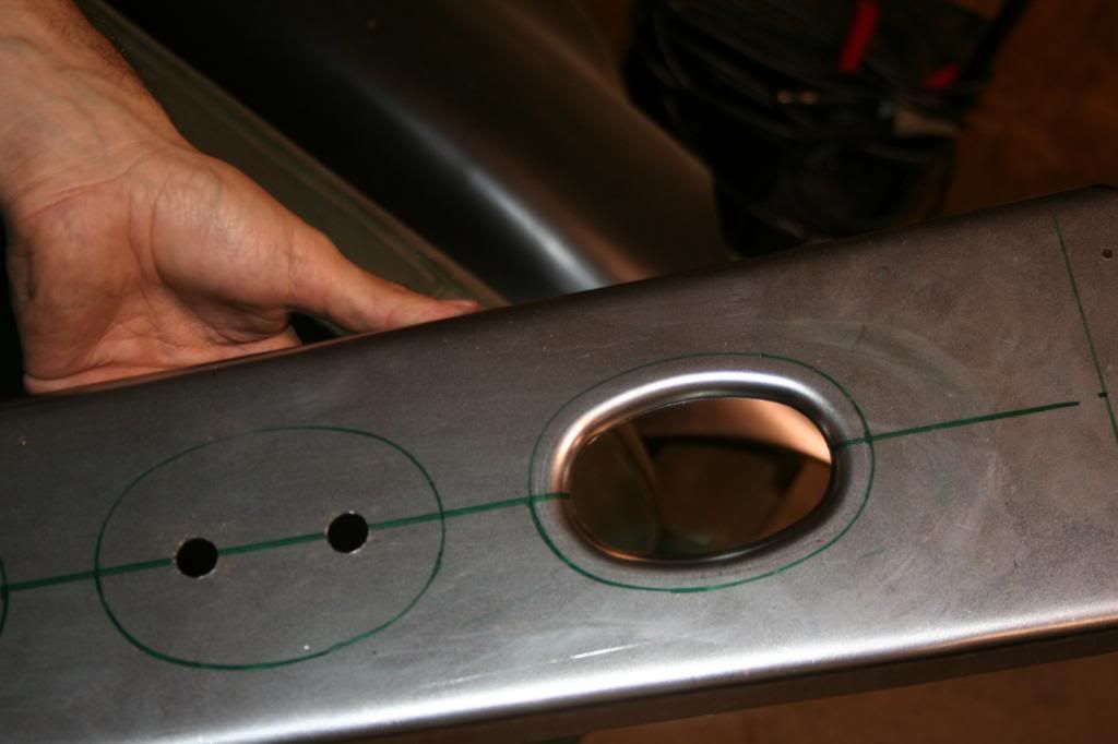

One of the what-if's were, oval dimple dies in the center divider....
http://i1365.photobucket.com/albums/...psdcb667ab.jpg
http://i1365.photobucket.com/albums/...ps313cb17a.jpg
http://i1365.photobucket.com/albums/...ps694655cc.jpg
http://i1365.photobucket.com/albums/...ps14f5d953.jpg
tchesney 09-25-2013 04:00 PM
http://i1365.photobucket.com/albums/...ps2daa89ce.jpg

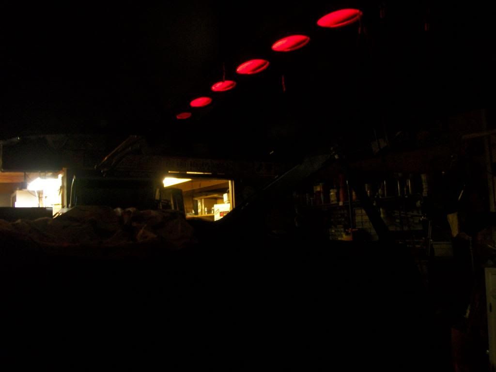

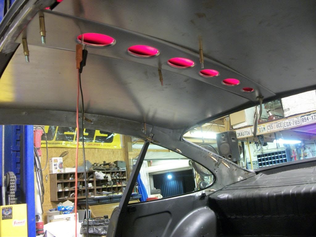

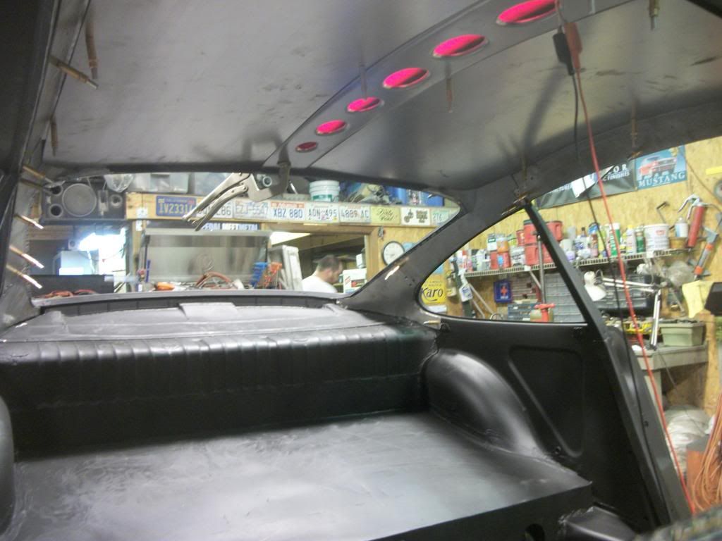

The next what-if's were, how bout we light that thing up? And put bead rolled filler panels in, (not bead rolled yet), and make them removable.
http://i1365.photobucket.com/albums/...psf92bddd3.jpg
http://i1365.photobucket.com/albums/...ps2e6e5f38.jpg
Well, one thing let to another, so let's fill in around the roof rails and smooth all that off, and simply paint it satin black, like the rest of the car.
http://i1365.photobucket.com/albums/...psb83f6c76.jpg
http://i1365.photobucket.com/albums/...psd8e1617c.jpg
Two rows of Red LED's mounted inside the center divider lends a real aircraft cockpit look. After all, the P-38 was a stealth bomber and operated mostly at night, so all you veteran bomber pilots remember that Air Force 90 degree flashlight that was issued with the red lens???? I've still got my dads and it still works. Anyway, that flashlight was the catalyst for this idea.
http://i1365.photobucket.com/albums/...ps62caa159.jpg

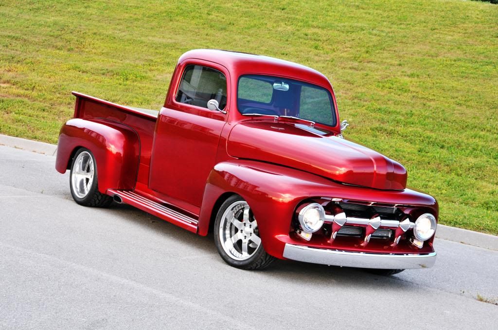

I have been grieving over that for a while now. I just finished a 1952 F1 truck that I shaved the drip rails and man, that was PITA!!, But it was worth it. Here is a shot of Moonshiner from a photo shoot that is coming out in the next few months in Classic Truck's Magazine. I'm still on the fence about shaving the drip rails on Night Lightning tho, It's not over till its over!
http://i1365.photobucket.com/albums/...ps4b35a5b9.jpg
