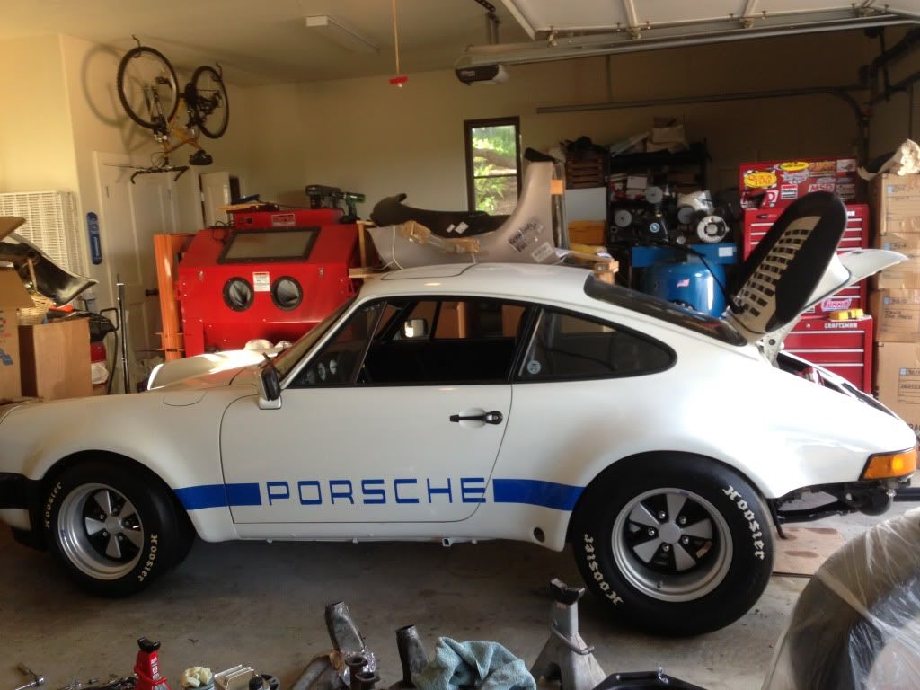

I looked at Hoosiers...um...no:
But it does look like a giant Hotwheels!
