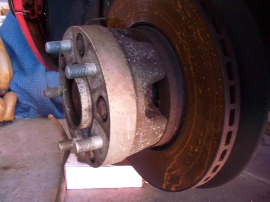

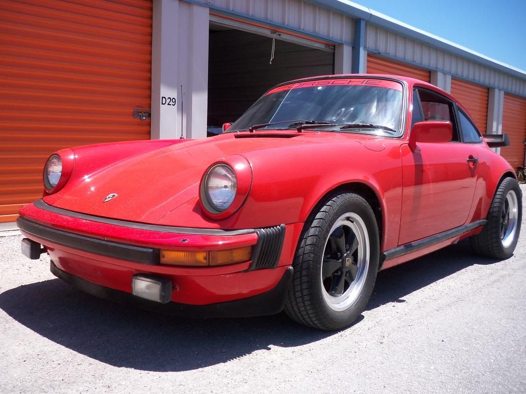

I knew there was some funny business going on when I bought this car (82sc), but it was cheap and I needed a new project. As you can see in the following photo, the wheels stuck out quite far:

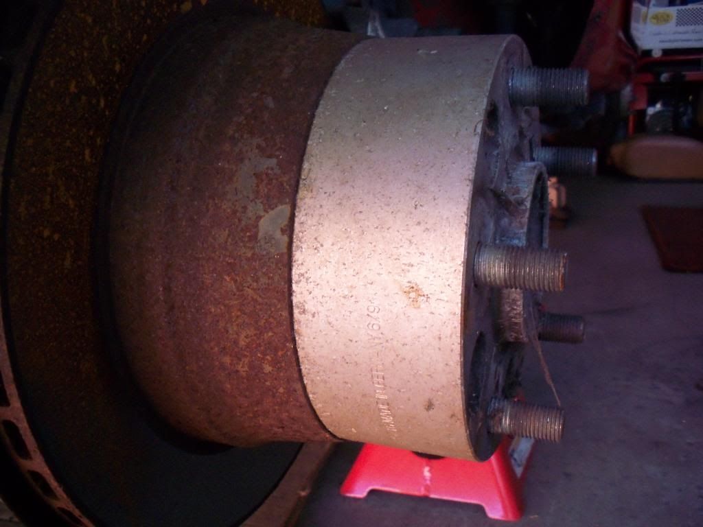

I finally got the car up in the air to finish the AC tear out (my favorite first task on a sport car). Here are some pics of the biga$$ spacers I found:
The front spacer measures 1 1/8", the rears 2 3/16"!! No wonder the wheels stuck out so bad. My questions are: Is it common to run some sort of spacer? If so what is the preferred size to run, front and rear? The wheels are 7" and 8" Fuchs 16".
Thanks for your replies!!
Carter

No spacers are needed, if you run the correct wheels. Have another look at the wheels and see what sizes you have and what part numbers they are. The fronts look like 6" and I can't tell from the photo what size rears that you have.

If you run 7" and 8" you may don't need any spacers. I run 6" and 7" and use 1/4" spacers in the front and 1" in the back. Try first without the spacers and do an alignment, corner balance and height adjustment. See how you like the look and go from there. Rigth now you can not lower the car without serious rubbing.

they look like replica 6 and 8x16 normaly no need spacer but what is the offset of these wheels.

An Sc/Carrera body car can use oe;
front 6ET 36, 7ET23.3 w/o spacers in 15 or16" these will have 911 or 951 part #s
rear
7ET23.3, 8ET10.6 w/o spacers these will have 911 part #s for the most part but the 7" rears could be 951 too.
aftermarket Fuchs options
front 8ET23.3, 951 wheels, w/o spacer, these are a poor fit in front but have been used they are extremely tight at the lips
rear
9ET15 w/o spacers these are 930 wheels and some even use a small spacer w/ them
8ET23.3 951 wheels will need ~10-12mm spacer in back of an SC/Carrera
The front spacers in the pics appear to be 930.341.611.00 which are used on early 930 front, 21mm thick
the rears may be 930.331.911.04 which were used on 930s, ~54mm
If you can find part #s on the spacers as well as the wheels we can determine what they are, the rear wheels definitely stick out too far

I didn't get numbers off the spacers, but they are all H&R branded. The measurements originally posted for the spacers are accurate. The fronts are more than 1" thick, so 26mm+. The rears are greater than 51mm.
I take it that I'm safe in ditching these, backspace-wise. They're currently soaking in PB Blaster.

Yes, feel free to get rid of all of the spacers. Not needed.

Technically, those aren't spacers, those are adapters.
I have 1" hubcentric spacers on the rear of the my 88 Carrera, 8x16 wheels, and to me it is just right. The tire just hugs the radius of the fender with no rub.....
