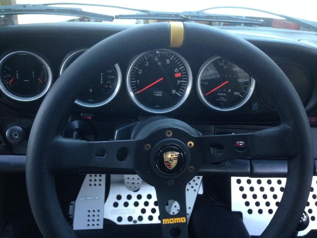

Henry, that wheel is yours or $150 plus shipping. I'll even throw in a Porsche horn button for another $20.00 if you're interested.
Byron, your SC is sweet! That trim piece is simply a brushed nickel door latch jam. The rest came from our host.

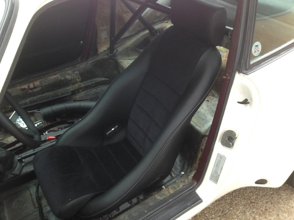

mreid 01-01-2014 04:25 PM

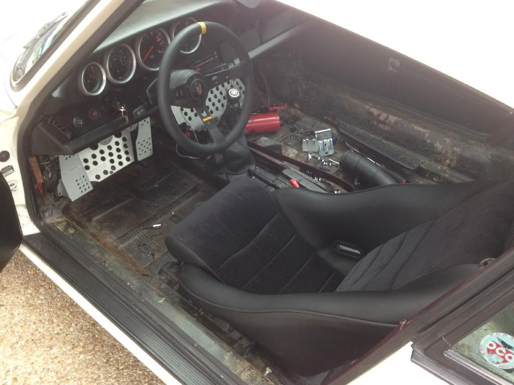

I mocked up the rollbar and driver seat:
http://img.photobucket.com/albums/v6...pskphvjbn2.jpg
http://img.photobucket.com/albums/v6...psylb5b5ld.jpg
Tomorrow I dye the remaining interior trim black, start removing the glue, I finally get to install the RS carpet set.

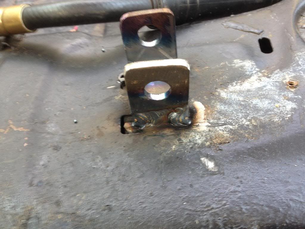

mreid 01-02-2014 04:39 PM

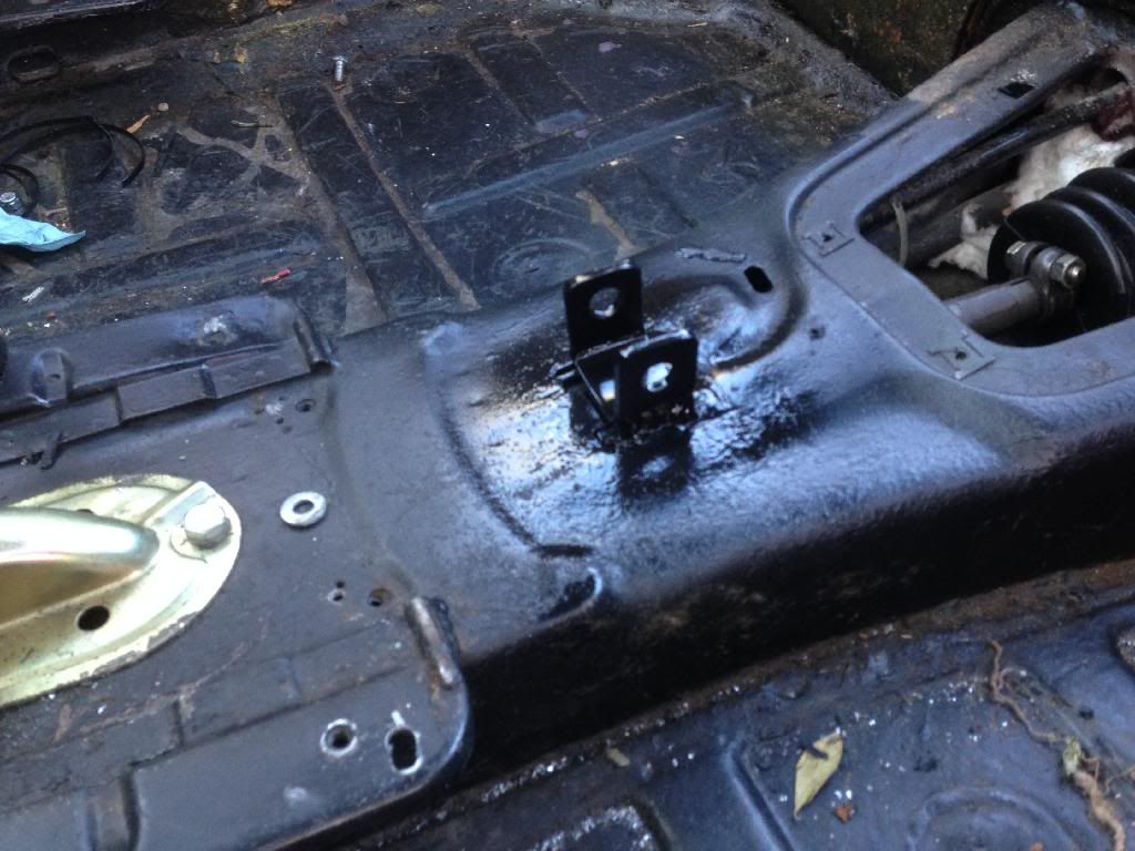

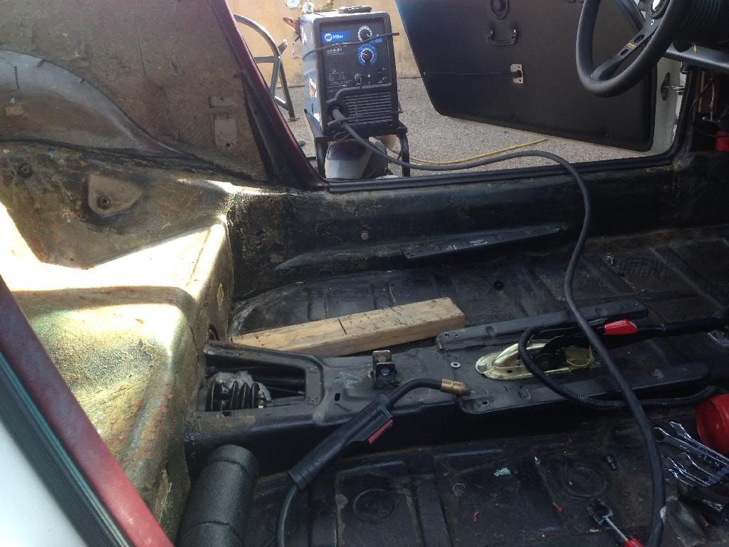

I fab'ed up a bracket for the inboard lap belt portion of the harness and welded it to the mount on the tunnel. I don't know why Porsche installs the inboard lap belt to a bracket bolted to the seat. Doesn't seem real safe:
http://img.photobucket.com/albums/v6...ps9p0uahwd.jpg
http://img.photobucket.com/albums/v6...psdnr74vv3.jpg
http://img.photobucket.com/albums/v6...psapk3nw3v.jpg

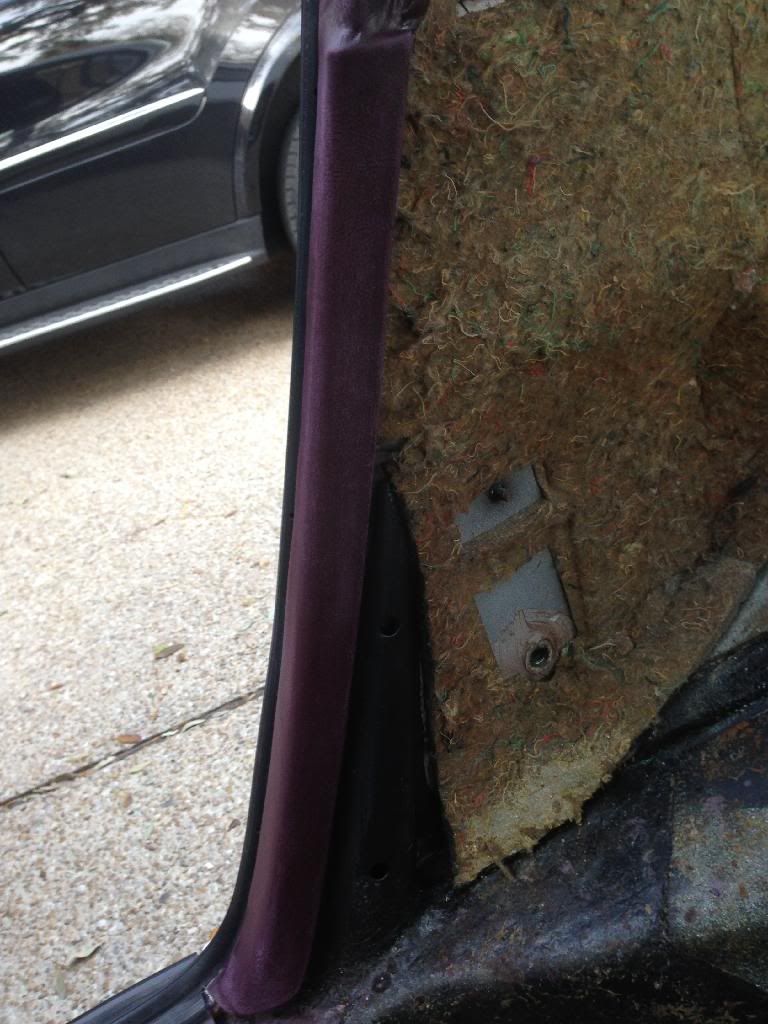

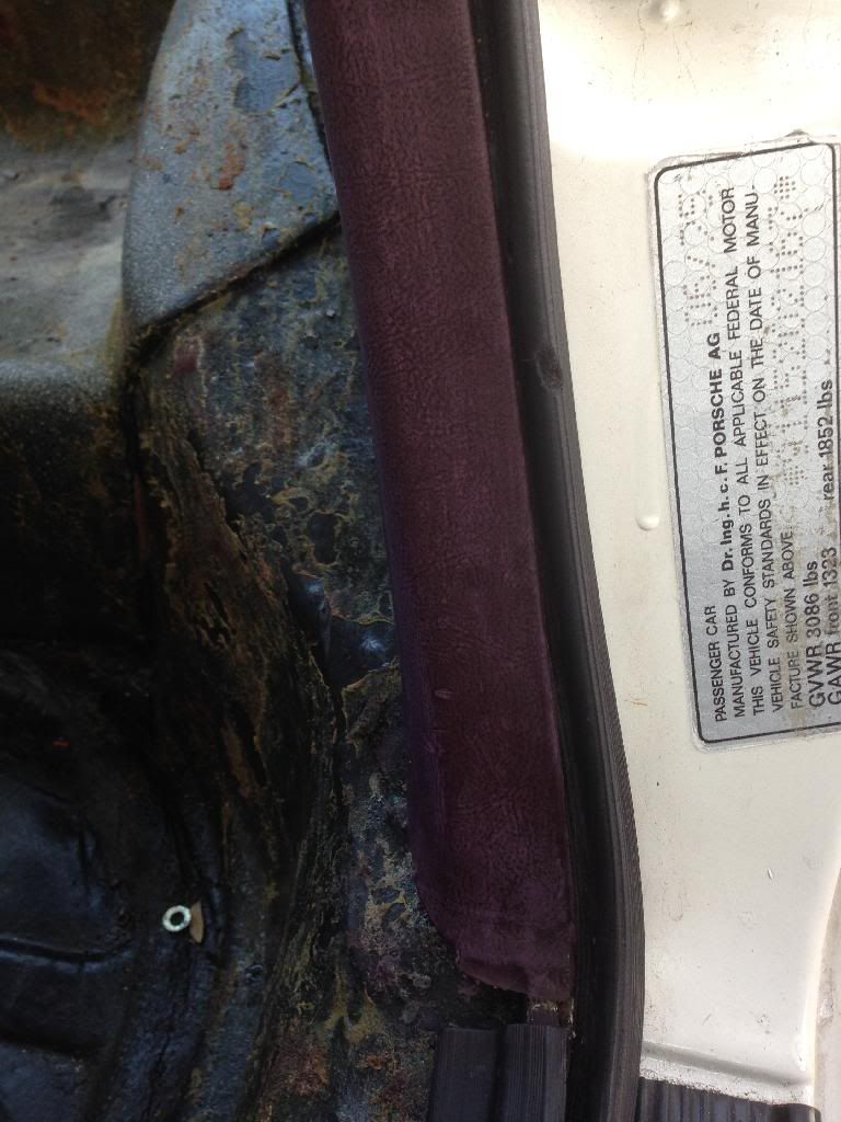

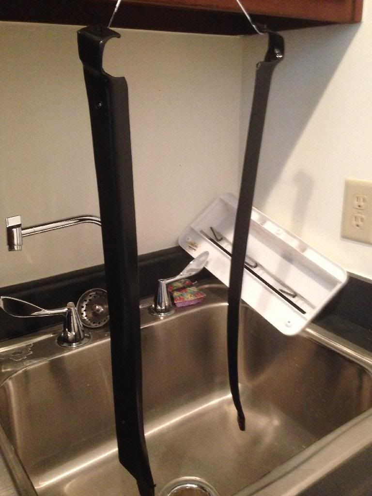

I also wet sanded the final six pieces of interior trim to be dyed black using the Leatherique cleaner to remove the top layer of dye and prepare the pieces for dying. And then dyed the pieces black. I hope my wife doesn't notice the two big trim pieces that go under the side windows hanging in her laundry room. That will be trouble!

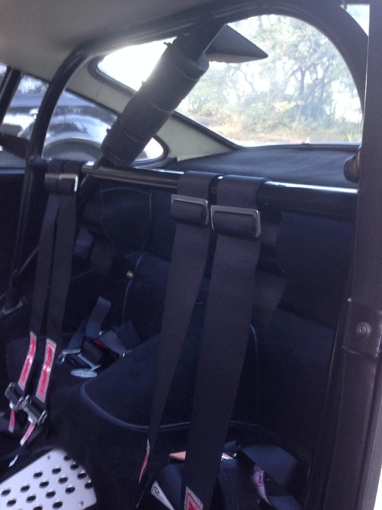

mreid 01-04-2014 03:09 PM
Picked up one of these today:
http://img.photobucket.com/albums/v6...psib4qwdy7.jpg
And made this:

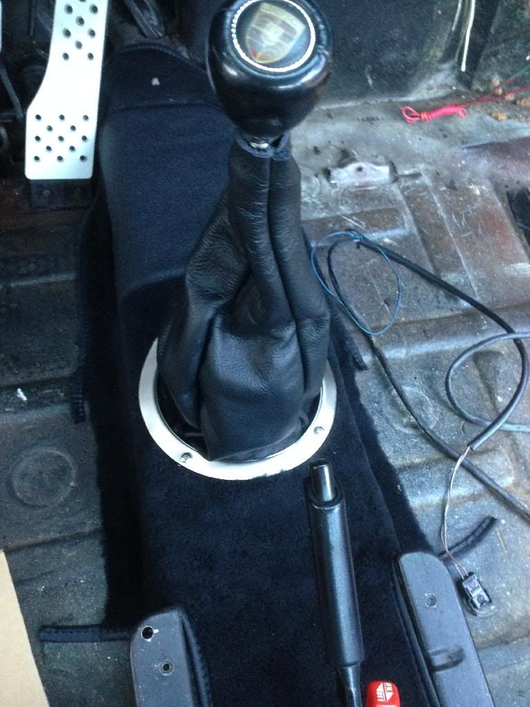

http://img.photobucket.com/albums/v6...psync6ublm.jpg

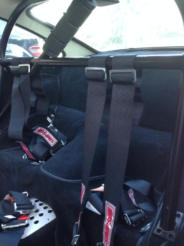

Also removed the glue (thanks for the citrus strip trick), installed the rear carpet, roll bar, and belts.
http://img.photobucket.com/albums/v6...pswynumsiy.jpg
http://img.photobucket.com/albums/v6...psxdweljtx.jpg
Should finish the interior tomorrow just in time to go back to work on Monday. Rats.

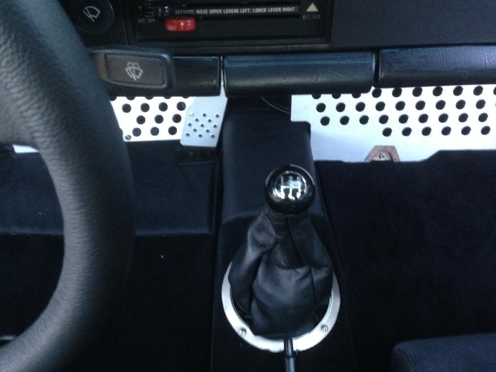

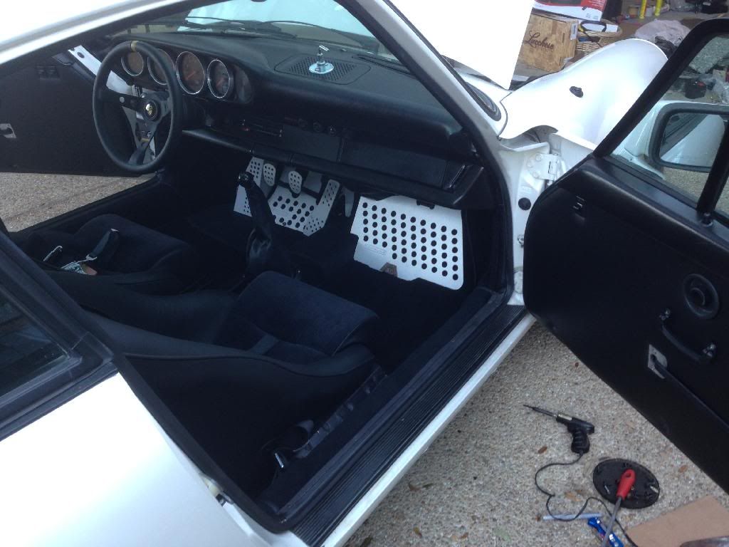

mreid 01-11-2014 03:15 PM

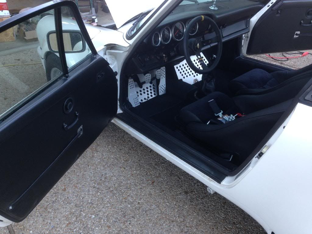

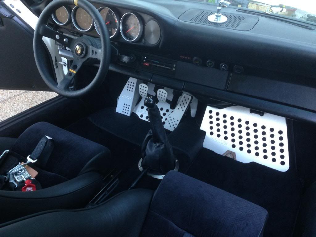

And then it was complete! Lots of work, but well worth it in the end.
http://img.photobucket.com/albums/v6...psw6n8sim2.jpg
http://img.photobucket.com/albums/v6...psnfkjhywi.jpg
http://img.photobucket.com/albums/v6...psu13mdxzl.jpg
http://img.photobucket.com/albums/v6...psuhnhbc8r.jpg
http://img.photobucket.com/albums/v6...pso6bixidq.jpg
http://img.photobucket.com/albums/v6...psfytgypda.jpg
http://img.photobucket.com/albums/v6...psqkqr4qwy.jpg
http://img.photobucket.com/albums/v6...ps9t9gzvum.jpg
RSTarga 01-11-2014 06:42 PM
The bracket on the seat rail is much stronger than what you have. You would need a backing plate on that sheet metal to make it strong enough.
The angle over your hips wing be optimal either.
