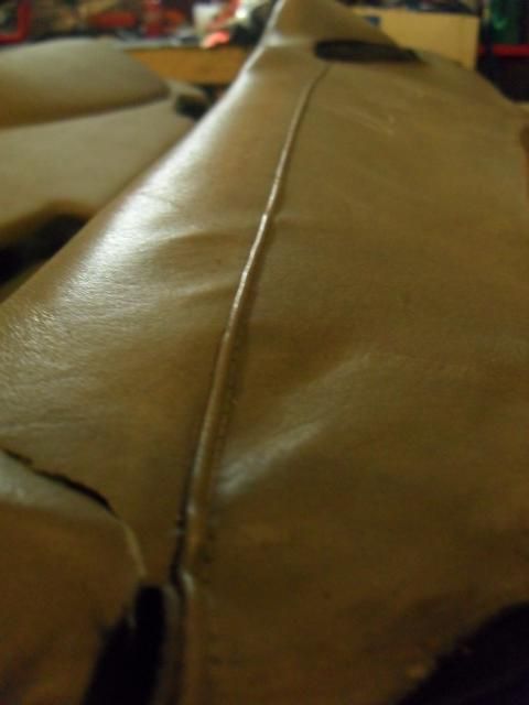

Joe Poindexter at Ace Auto Fabric 816 221 8370 has a love for Porsches, as seen by his 79' 930. He can do wonders ( in bus 57 years) to most any dash. Cracks fixed for good. Here are some photos of a job he just finished for a Boxster customer. I can get 911 photos of a french seamed dash if you like. Can use any type of leather including OEM material.

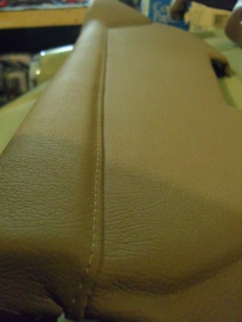

I had my dash done by Auto's International. I purchased the leather from GAHH to match my Weissach. The stitching is the same BUT the other way. you can see in the pictures what i mean. I love it. The workmanship is superb and couldn't be happier. The first picture is the original Weissach dash.
