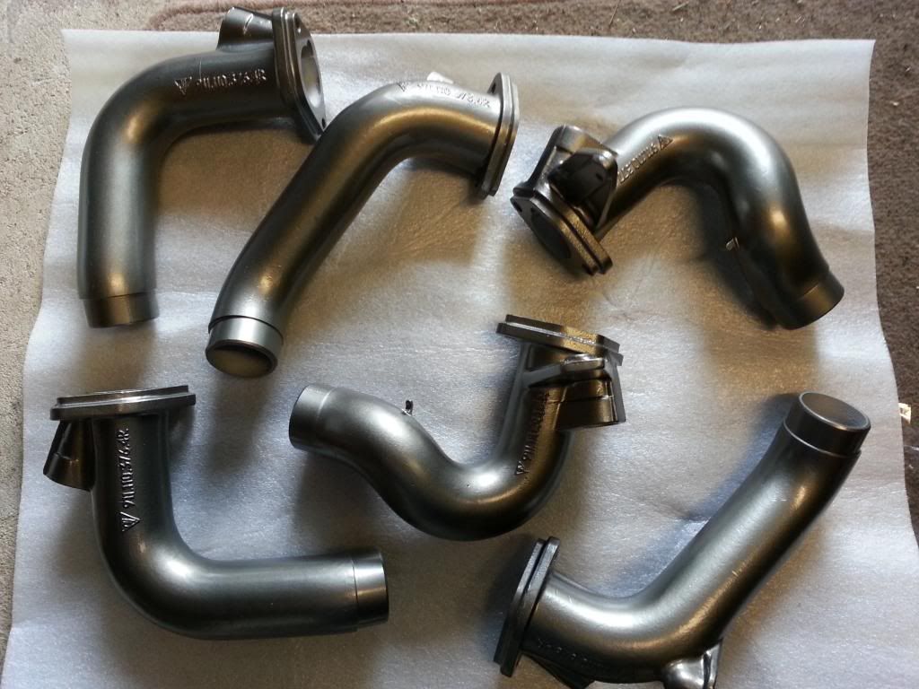

Pic is of powder coated chrome runners. Don't do this as the coating will stain way more easily than basic colors.
1981 911SC Targa

When I reconditioned mine I didn't re-stake them ,new rubbers and o-rings made them so tight.
some feel a little loose .0001 but when you start it up even at a low idle they suck right down and become very rigid.
And I was worried about cracking the plastic tubes.
Dye grinded and coated shame you can't see more of them.
