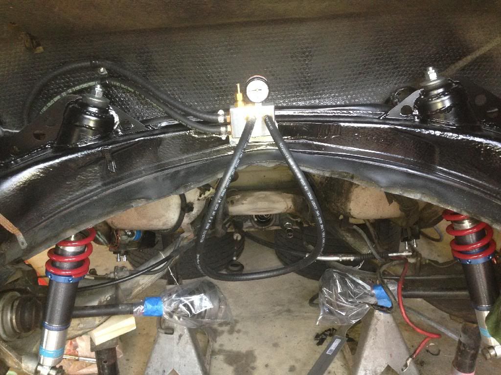

Wow, only list the hours spent working. 10-20 tops, but are you grinding off the flimsy rear sway bar frame brackets and welding on wevo heavy duties (add two hours)? Are you replacing the banana arm bushings (add three hours)? While the banana arms are out, will you replace the wheel bearings (add two hours)? Add three hours to do the brakes, but if the rear parking brake requires more work add another one to two hours. If you're taking 40+, you're doing a lot of noodling or fooling around. Oh, and if you're doing rear coilovers, you really need to weld up the rear shock towers and reinforce them. Here's my 74 with rebel racing bushings and coilovers I installed a couple months ago:
