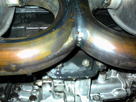

Here's a few pics of the system mounted, I haven't gotten a good shot from behind yet since I'm terrible with a digital camera. here's looking in from the driver's side. here's a close up of the crossover

I made this prototype with regular steel after dyno testing I plan to make another that fits a little better out of stainless. So far it's much quieter than the Flowmaster with definately more midrange.

That exhaust looks even better mounted! I cant wait to see your dyno results. I was wondering what the exit tips look like on the car? Have any more images?

I'm trying to get some pics of the exhaust from behind so you guys can see but I'm having trouble with the white paint on my car messing with the exposure on my digi-cam, all you can see in the pics so far is the body because the pics are too dark. I got some tips from others on how to take better pictures that I'm gonna try tomorrow. Since this is only my prototype they're just cheap chrome tips welded straight onto the mufflers, no down turns just straight side exit.

Hmmm, seems I may have been beat to the punch on the x pipe idea on a 911,
Available from Pelican no less!, major difference here of course being the fact that I'm using 2.5 inch pipe and on my final design a true performance muffler. I've selected four candidates for mufflers all with excellent flow ratings so it's going to come down to sound quality. Can anyone confirm that the Manta exhaust has a true X pipe crossover configuration? Or are the pipes just really close together? I noticed the Manta has three bolt flanges with smaller mufflers on their side, could this actually be a pic of a 912 exhaust and not the 911 version? I doubt there's room for the mufflers on their side on a 911 unless they're very narrow.
On another note, I can't wait for a chance at the chassis dyno! This prototype definately has more midrange than the Flowmaster I had on the car, I took the exhaust off this morning for some minor tweaking of the fit and decided to pop the flowmaster back on for comparision, it just doesn't have the midrange pull of the X-pipe.
