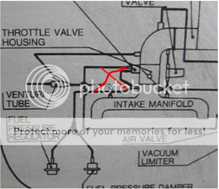

When doing the fuel pressure tests, I discovered that the vacuum line for the fuel pressure regulator was hooked up to the temperature switch on the throttle body. The correct location is below the throttle plate as shown in this pict.
[IMG]http://i1349.photobucket.com/albums/...ps2d04a8c3.jpg[/IMG]
- Remove the vacuum line from the FP regulator and attach a vacuum gauge directly to the end of that line. What's it read? 3 psi
- Do the same thing on the Fuel Damper vacuum line. What's it read? both should read the same. 3 psi
- Take another reading of vacuum at some other manifold point. What's that reading? All three readings should be the same. I used the power brake line and got 3 psi. Yes, they are all the same.
- Next, connect a hand vacuum pump to the FP Req and apply vacuum you should be able to drop FP down to 2.0bar if you can't the FP Req is bad. 5 psi of vacuum op press regulator causes 5 psi drop in fuel pressure. Conclusion press regulator is good.
- Get us you manifold vacuum number at idle, if I recall you need like 50-60kPa of vacuum. That's in the -7.5PSI range or -0.5bar I assume this is the same pressure I measured at all three locations (3 psi)
- Rev the engine up to say 2000 RPMs does the vacuum change? Yes.. At 2,000 RPMs, I get 6 psi of vacuum and fuel pressure is about 32 psi.
Based on these tests, I conclude my fuel deliver system operates correctly. So the question is: Is the my low manifold pressure a by-product of my GT2 cams or bad cam timing?

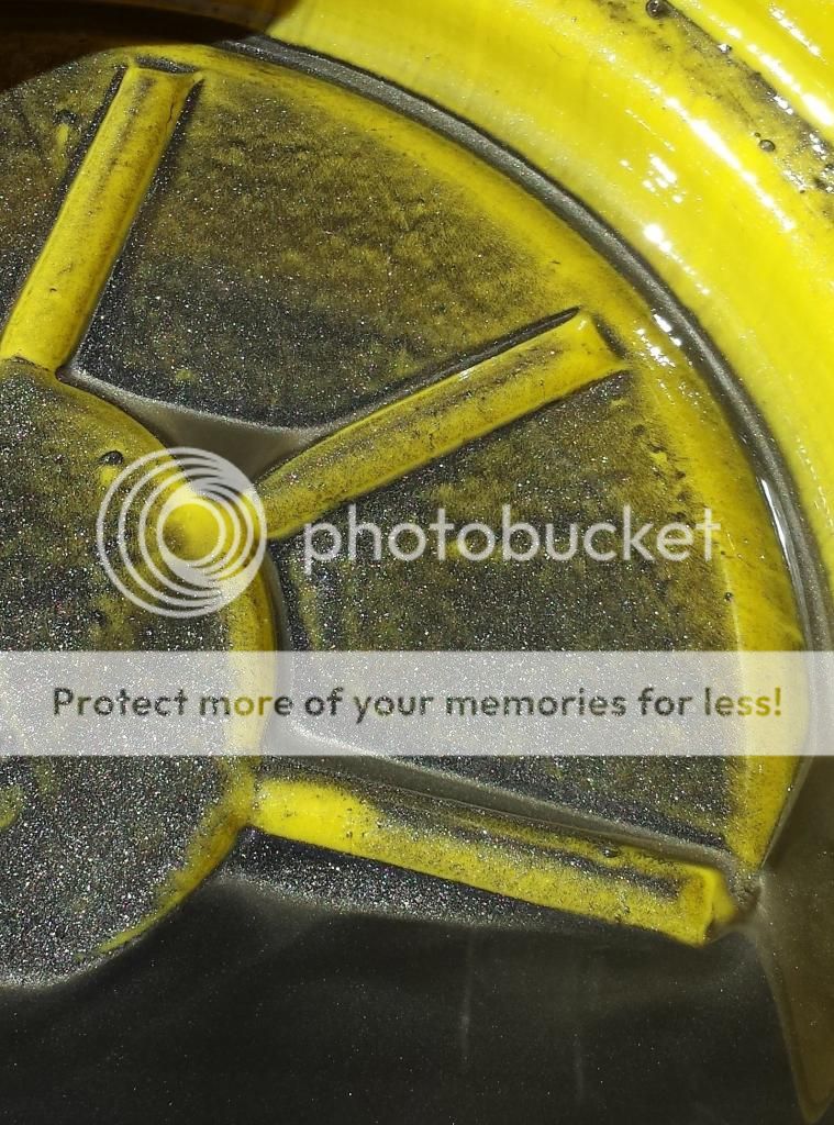

My transmission locked up (can't get it out of 5th). I changed my transmission oil this weekend because of strange whirring sounds. This is what the bottom of the pan looked like:
[IMG]http://i1349.photobucket.com/albums/...ps8d989142.jpg[/IMG]
So, I knew that it was dying.
Just when I was finally getting the engine sorted--Thanks to Sal Carceller. AFRs were around 13.0 under WOT and 14.7 at idle. I imagine it will take awhile to get back on the road.
Sad, sad day.
scarceller 09-25-2014 07:23 AM
Tim, this really sucks! I feel for you, stuck in 5th gear is bad.
I'm not a trans expert maybe others can chime in on those particles in the pan? Any large chunks of metal? or just small flecks?

No large chunks of metal. Just metallic flakes.
