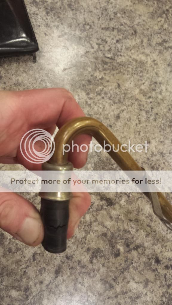

I found a couple vacuum leaks tonight (see pict). Boy, I have new respect for vacuum lines. I went thru and tightened every hose clamp I could find. I probably won't have a chance to fix the cracked hoses until the weekend. Also, the Idle switch will take 10 days to get here. So, no update on drivability.
(I also checked and cleaned the ICV.)
Injectors too small? Yes, some others have already suggested this. For now, I am going to fix the below 4,000 RPMs... but to get the most out of the higher RPMs, I may be looking at bigger injectors and a new SW chip.

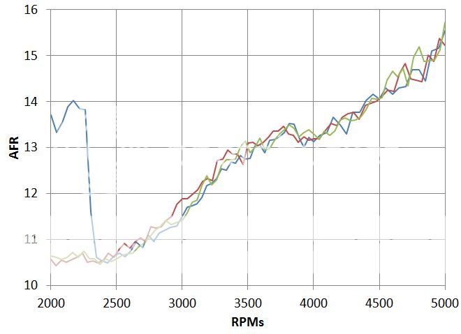

Did not get much done this weekend, but here is what I did:
• New fuel pressure regulator (difficult to get back there)
• Repaired vacuum leaks
• Checked static timing (good)
• New DME Relay
• Checked for dead cylinders (none)
Then I did a couple runs with my LC-2, here is what I got:
(Yes, I know this sucks). Next step is to swap out the DME and chip. Hopefully chip was designed for higher octane, non-ethonal gas. (I am still waiting for new Idle switch).
Oh boy, running out of ideas...

If you run with the stock air flow meter, make sure you are using a chip program designed to run with the stock air flow meter, and not one for the Autothority MAF. If using the Autothority MAF, you need a special custom chip for that sensor. The two are completely incompatible as the V(out) curves are a complete inverse of each other. I don't see what chip and sensor you're using in your AFR test, but from its looks I'm guessing you're doing a mix and match.
Old 08-12-2014, 09:45 PM
jungspike's Avatar
Join Date: Nov 2013
Location: Castle Rock, CO
Posts: 166
Yes Steve you are correct. I'm a dumby. I was running a chip meant for the hotwire MAF with the stock flapper box.
I put the MAF back on and it runs MUCH better.
However, AFR still climbing to 15.0 at 5,000 RPMs.
I'm done for tonight, but I am excited for the improvements... Thanks Steve!

Installed the flapper box and a borrowed chip (chip maker is Road & Race Inc.) and did a run. Here is what I got:
[IMG][/IMG]
The "dyno" data was on a Dynojet (with Hotwire), the "Hotwire" data is from two days ago with the Autothority MAF and the "Flapper Box" is with the stock air flow sensor and the "Road and Race" chip. The last two sets of data are taken from my LC-2 wideband O2 sensor (I show the dyno data, only to show that the LC-2 matches it). So... I guess most of my lean problem is from from a chip that wasn't tuned for my engine (just like Steve W told me).
84 911 Targa 3.4L

Just got a new SW chip... Great improvement: AFR is now around 13.0 at all RPMs below 5k. (I won't take it above 5k till rings are seated.) I still have some parts of the Motronic that need to be checked/tuned. After I have gone through every part of the system and have 1,000 miles I'll re-dyno and report the results.
I appreciate all the help/advice from my fellow Pelicans.
