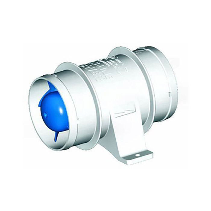

BTW - this only tells part of the story - I had HE that were only drawing heat through the footwell blowers (and on a cabriolet). If I did it again - I'd probably go the bilge blower route.

Hey Jeremy what exactly is a bilge blower? Something in addition to the stock blowers on my 3.2?
I recently backdated my heat and took off my engine compartment blower but could reinstall it if needed.

Bilge blowers from a boat - have heard of several folks using them successfully.
Rule Marine In-Line Blower
