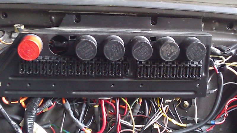

Hello,
Decided to drive my 911 in the rain and after 30min into it, my headlights and taillights went out.
Is there a single source of failure that would cause both to go out? A common ground or fuse?

There are schematics for the 81SC posted on this site under the parts catalogue web page.
There are several checks you can do to help isolate your issue.
1. With no key in the ignition if you pull back on the dimmer headlight/turn signal switch does your high beams flash on as long as you hold the switch back. They should and this would mean you have battery voltage at terminal (30) of the light switch. Also if you select the right or left turn signal position the parking lights should come on for the side selected.
If the high beams do not come on then your problems is the battery voltage at terminal (30) of the light switch which is supplied from terminal (30) on the ignition switch and the ignition switch is supplied from the battery.
If the above test works then:
2. With the ignition switch turned to on check for 12 volts at terminal (75) on the Light switch. If it is there then your failure is in the Light switch. If you do not have 12volts then check terminal (X) on the ignition switch. If the 12 Volts is there then you have a bad connection between the light switch and ignition switch.
If you do not have 12 volts at terminal (X) on the ignition switch then you have a problem at the ignition switch between terminal (X) and terminal (30).

Actually, that Rats Nest doesn't look too bad for a 33 year old car. Do you have a copy of the 81SC schematics?

I just noticed the added on ATO fuse block, Humm, that needs to be accounted for and compared to the schematics.
In my own case, I modified my panel to accept ATO fuses and it was a (FUN) experience doing the conversion and then doing continuity and power checks to make sure all was correct and matched the schematics. Granted, It is a job that requires a reasonable amount of technical skill related to testing and troubleshooting electrical circuits and the capability to understand the flow of electrical schematics. On my panel I added 5 additional fuse slots for expansion.

I do not have the schematics yet but will search for it when I get home. My car didn't even come with a fuse box cover.
I was thinking about just converting it all like yours, just didn't think I'd start working on the electrical items during the winter. That looks so much better, I'm just a military man and know very little about electronics. How hard could it right? haha

Hello,
Finally got a chance from work.
So when I tried your test targa80, my high beams did not work with no key.
Signal left - nothing.
Signal right - headlights and taillights work.
Yikes

Actually when I signal right, even my high beams work.
With the keys in, left and right act appropriately. Hmm.
