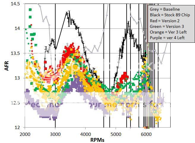

For about 2 years I have been fighting a lean problem in my 3.4L Carrera (see link for history Crappy Dyno Run (Part Deux)).
Here is where I am at:
[IMG][/IMG]
The grey line is where I started trouble shooting. After exhausting every check of the Motronic system (with the help of Sal Carceller's help), AFRs were at the black line. Then I started to burn my own chips. I finally got them to the purple line. It is a lot of fun burning chips! I still have lots of work to do, but a least the car is safe to drive now.
