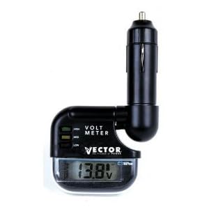

One thing that has been present since I bought my '88 Carrera a couple months ago is voltage fluctuation.
The lights will dim and the blower slows down. I don't notice any decrease in performance or stereo sound.
I was first thinking (hoping) it is just the voltage regulator but it seems that would point towards a voltage spike, not a drop.
My other thought it that maybe it's not dropping and it is in fact spiking. Because when the lights do get brighter, they are actually pretty impressive. People always say the H5 are terrible, which they are most of the time unless the voltage increases.
I haven't ever driven another Carrera and don't know what's normal.
What I might just do is buy a regulator and take the alternator and have it rebuilt locally just to be safe. I'd hate to spend $300+ on a new one if that's not it but I could live with $75 for peace of mind.

$2.85 shipped from Amazon

If you don't buy the cigarette lighter meter posted above, use a length of speaker wire to connect a multimeter to your battery. As you're driving (and particularly when you notice the electrics doing funny things) turn on the voltmeter (which is wedged between your windshield and dash) and see what's going on at your battery. Is the voltage dipping down into the 10-12 range? Or is it spiking to 16-18v?

Plugged in my $3 digital Amazon.com voltmeter in to the cigarette lighter outlet and drove it to dinner the other night. Whenever the lights would get bright and the fan kicked up speed it would read 17.1 up to 18.9 volts.
Just ordered this
