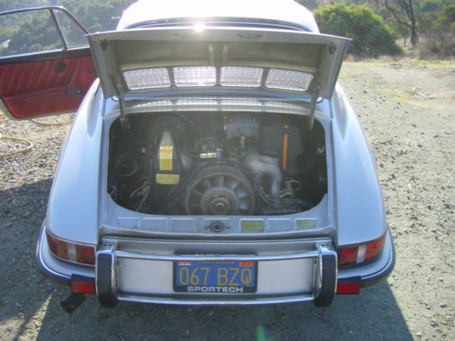

just thought I would post a few pictures of my 1970 911 T conversion. It is especially fitting since it looks like Jack is "killing" a car almost identical to the one I saved. Not that I think building a track car is a killing, as long as he parts out the original Black beauty and lets her live on in a manner of speaking.
So mnine is a 1970 T with a Carrera suspension, 3.2 L, and a 915.
to refresh this was a pretty stock 911T, and I bought a 1985 targa and moved everything over, adding adjustable spring plates, hard bushings everywhere, and solving miss matched bits and pieces here and there. Has Bilstein HDs, and pagid orange pads.

WOW WOW WOW....what a cool car!!!! The stance is dead nuts right! Are those 16x7 tucked under there? Factory flares? I have 16x6 on my 70S and I would like to lower it more.....but Im afraid of rubbing the inside of the fenders and screwing up the paint. How does it ride sitting that low? Not crazy about the high-back seats, but what a cool car!!! Love it!

I thought I would answer a few of the questions
Tires are:
front 205/55/16 on 6" rims
rear 225/50/16 on 7" rims
I needed to put a lot of camber in the rears to get a fit, an I needed to roll the fender lips at all four corners
I too think the high back seats are a little out of character, but this is going to be commuter and daily driver so I went for the comfort of the newer seats.
The head lights are stock for a 1970, I have a set of H4s which I might put in, but these make the car look really original, maybe makes up for the seats :-)
Finally the car is running great, it tips the scales at just over 2400lbs, seems pretty quick, and handles very well.
Jim

Nice car- don't know how you managed to fit the 225 rear tires in?
Mine has 205's on the 7's at the rear and the PO had them too low and wrecked the new paint job
He also tried to roll the fenders and cracked the paint then gave up by the look of things- that metal is hard!
I would love to fit those tires- any idea how much camber you have?

Wow, 7's on the rear with 225's AND lowered, no flares! I've never seen that work before. Save this one in the archives for the next "can I fit these wheels..."

a few more details,
I only have crank windows, the door panels have the squares cut in them for the power windows, not sure how I am going to cover that up, and the cranks are coming out of a hole designed for the smaller of the speakers a 1985 came with.
Putting the late style door panels on the car was not easy, infact I still have to do the passenger door. It takes a lot of time and fiddling to get them working. The other reason I don't think I will put the power windows on the car, I would like to have them but weight and difficulty will most likely stop me.
If memory serves me, here are the alignment specs
front
as much camber as I could get(over -1 for sure), as much caster as I could get, 1/8 toe out
rear
-1.5 degrees camber, and 0 toe
the only ride height measurement I remember is from the ground to the bottom of the torsion bar housing, the round part that sticks through the bushings and makes a good place for a jack stand, was 9.5 inches, add ~1 degree of rake to get the front right and that is it.
