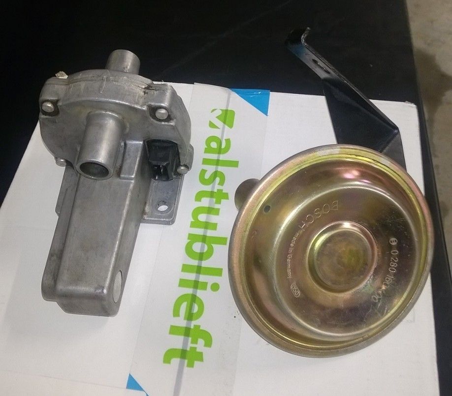

I took a closer look and it indeed has another number hidden behind the vacuum connection, which ends in -045.
Engine was off during these tests. System fuel pressure is in the list (4.95 bar).
When I remove the oil filler cap the idle speed drops by a 100RPM or so (from 950 to 850) and starts to fluctuate up and down a bit (maybe 50RPM), which I think is how it should be?

Where do I find the correct WUR resistance? And how do I check CSV / AAV?

Updated list leaves only 2 options:
Troubleshooting would propose the following reasons for hard cold start:
- Sensor plate / plunger not moving freely I can push the thing up and it seems to fall back freely so unless there's more to it; not it
- AAV/R not open
- FP not operating This is not it since the car does run warm
- CSV defective It does start/fire on the first try but then dies, so with Bob's info this is also not it
- WUR defective If 26 ohms is correct then also not it I guess?
- Cold pressure outside tolerance I believe this is correct too looking at the attached graph
- Injector leaking, opening pressure too low Injectors were all renewed 3 years ago
- Injected fuel quantities unequal Injectors were bench tested last year after the car stood still for 9 months, correct&even spray pattern
- Basic idle setting incorrect Idles well at 950RPM when warm
Is there any way to check for correct AAV/AAR operation on the car or do I have to remove them?
The funny thing is, it doesn't take long for the engine to 'pick up' its normal warm up routine, if the AAR were defective it would idle bad throughout the cold up right? And the AAV only provides initial air until the vacuum is built up, so it's not something that would kick in after 10s, only shut off.
So what could make my car stall on the first 2 tries, then let it idle rough/low for 10-15 seconds and then finally kick in to bring the rpm's up to normal cold running @1250rpm ?

In the CIS Troubleshooting thread there are links to test procedures for both the AAR and AAV. You will have to remove the AAR. Maybe you could test the AAV in place but it would be easier to test if removed.
The AAR has an electrical connector just like the WUR is on the same circuit as the WUR. An easy test is just to make sure it is getting 12v too.

Niels
Niels911SC's Avatar
Join Date: Oct 2011
Location: Sweden (Prev: The Netherlands)
Posts: 85
No worries guys, I got them both out without too much of a hassle:
I'll bench test them this week with the help of the two threads in the CIS troubleshooting
AAV: How to test Auxiliary Air Valve
AAR: Is This AAR Good or Bad
It'll be a busy week so I hope to be able to test them one of the evenings, but it could take a little time. I'll post a report when I do.
'78 911 SC Targa
