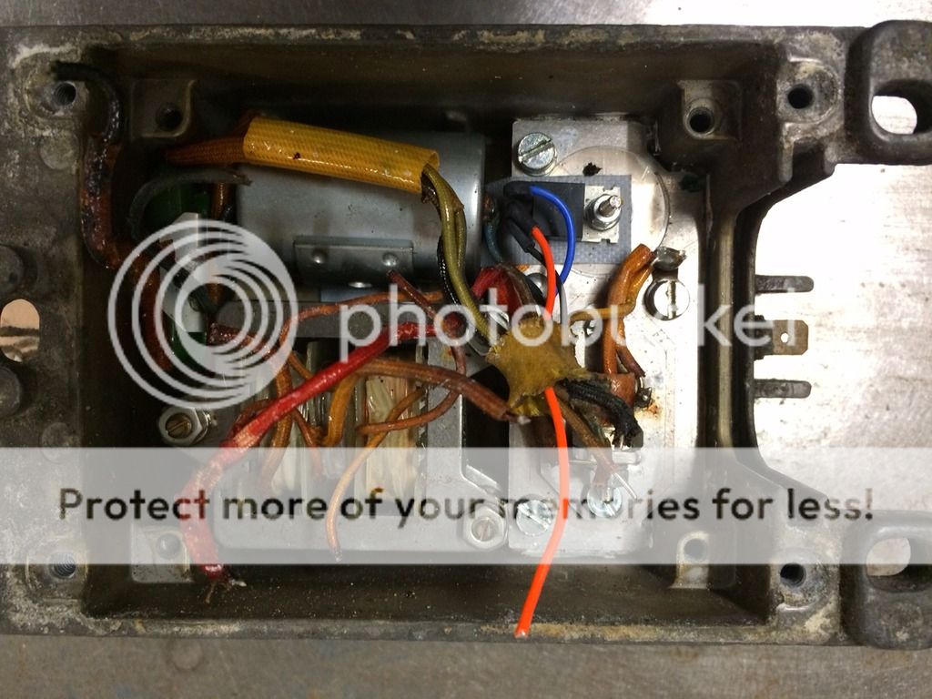

Here you go, see the 'repair', just waiting for the next 40 year old component to fail:
In this case the customer didn't want his Bosch case refurbed, so we left it warts and all:

Yep, the last two boxes we had in for gut and upgrade were 'repaired' so YMMV.
Sorry, you are simply pissing up wind, looks aren't everything. I would readily rely on a Porsche CDI that has endured 40 years of operation vs risking the infant failures of a complex CDI+. Have you calculated the MTBF of your CDI+..?
Warts..?? Beauty is truly in the eyes of..

The future is in repairing CDIs as it is relatively easy with non-potted units.
Or avoid the need altogether by using best practices. Keeping all connections clean, tight, and bright. Maintaining point and plug gap and change intervals to keep from stressing components. Using dialectric grease where necessary, etc.
Jeff
