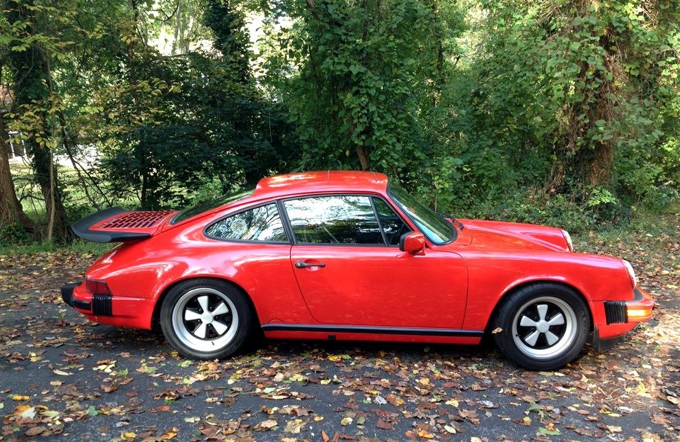

deputydog95 09-21-2016 07:00 PM
Thanks for all the great responses.
I'm running a 225 RE11 up front on a 7 inch rim with an offset of 23.
The rear is a 245 RE11 on a 9 inch rim with an offset of 11.
My shop went a little overboard lowering the front and the tires started rubbing pretty bad. They rolled the fenders (naturally the paint cracked) and it seems I have the appropriate clearance now.
Just not sure I like the balloonish look of the 225 on the 7 inch rim. It doesn't understeer as much though...
The 245 in the 9 inch rim looks pretty good.
We're going to lower the rear and do a proper alignment soon as it's raked up a bit now out back.
Curious what you guys think of the setup and suggestions?

scarceller 09-22-2016 05:45 AM
deputydog95,
7" rims look perfect with the 205/55/16 tires, with this tire the rim just looks correct. The sidewall height looks right and the tire does not balloon.
In addition, I think the side wall height of the 205/55/16 will closely match the rear 245/45/16 on the rear. Here's a good calculator:
Tire Size Calculator – Tire dimensions/diameter/circumference/revolutions per mile
The 205/55/16 has sidewall at 113mm
The 245/45/16 at 110mm

911pcars 09-22-2016 07:50 AM
205/55 and 245/45-16 tires have about the same overall diameter. It's a commonly-used tire combination for RS, SC and Carrera flared cars with few issues when used with 7&9" Fuchs (front tire-to-lip clearance when lowered).

I run this 205/55/16 size on 7" rims on the front of my 84 M491 Widebody it's the spec tire for the car as listed on the sticker in the engine bay. When I bought the car it had 225/50/16s on the front they just looked wrong on the 7" rim. I'm far more satisfied with the 205s. Overall side wall height is the same but the tire does not look ballooned on the 7" rim. Not sure about them rubbing since I have a the wide turbo fenders on my car I've never had issues like that. You won't be disappointed.
The 225/50/16 in my opinion belongs on a 8" rim, my same car has 8" rims on the rear from the factory and the spec sticker shows the rear tires to be 225/50/16s. I simply followed Porsche's specs for the 7" and 8" rims, figured that would be wise. The car looks far better now. I have pics before but I'd need to take a pic now so I can share the before and after.
