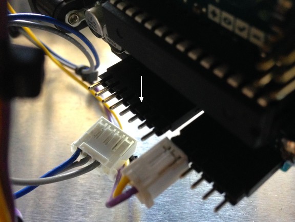

Relay #2. Is same as 1st. Comes with (blue) jumper that de-isolates relay’s coil power from Arduino. Will remove jumper and serve 2 isolated power supplies to relay. On signal side goes Arduino power. On coil side am going to test 12v stepped down to 5v 3amp served from car's fuse panel. Ground on both sides is common.
http://forums.pelicanparts.com/uploa...1480719113.jpg
Different approach this time. No soldering/heat.
http://forums.pelicanparts.com/uploa...1480719184.jpg
New step down for 5v test. Intentionally got this so preferred gauge wires can be attached. Using 16 gauge on 12v side. 26 on 5v. Will “bench” in car tomorrow morning.
http://forums.pelicanparts.com/uploa...1480719266.jpg
Discseven 12-03-2016 11:15 AM
2nd relay - Not working either. This time heat is not a potential culprit. Power is feeding coil side and I confirmed (via YouTube for this relay) that 5v works this coil. (Last relay 12v was going to coil.) Power is going HIGH and LOW to signal pin---I checked the pin to confirm when: When relay’s LED light is ON, power signal is LOW. When light is OFF, power signal is HIGH. (That seems opposite to me but doesn’t matter at this stage.) What matters is the normally closed side which has continuity to the common… that continuity never changes regardless of the relay signal being HIGH or LOW / light ON or OFF. I tapped on the relay to possibly free a stuck coil contact but that did nothing. I also tested both relay switches (as this is a dual config)---same results for both.
If relay has power to the coil---and it does, and the signal is changing---it is as I measured & confirmed at the signal pin... continuity with the common should change between the relay’s normally closed and normally open terminals. That’s not happening. Fact that both the 1st and 2nd relays are behaving the same… finger’s pointing to human error. What have I got wrong here? There’s power offered to operate the coil and the signal is shifting and no relay magic…
Seems I’ve tested everything but have I?
Electrical expertise is most welcome.

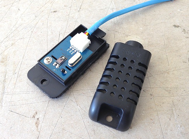

TEMP & HUMIDITY SENSORS - Two DHT temp & humidity sensors exist in system---an inside for cabin temp reporting (toArduino and data display screen), serves to compare target Set Temp to Cabin Temp with system cutting compressor OFF when both temps match. System turns compressor back ON after hystersis buffer is achieved. Outside sensor monitors ambient temp and humidity for entertainment only.
Having tested DHTs under various circumstances, there’s doubt as to whether the exterior sensor will continue to operate successfully after a 100% humidity experience. Reviews say these DHTs work through 100% humidity. My experience suggests differently---but then I forced cold & humidity on the DHTs for testing purposes. Perhaps a DHT responds more favorably to “real world” temp & humidity change. Because the exterior unit is wired and Arduino is programmed specifically for the two DHTs… will leave exterior DHT to the test of time. Cabin DHT should experience no issues.
With the first DHT’s failure (due my wetting it,) a new unit has replaced the wetted one. New unit was also subjected to 100% humidity. Humidity data froze at 99% (according to info displayed on the system’s data screen). Sensor was disconnected at housing terminal… humidity sensor wiped off… AC powered OFF… sensor reconnected... then system powered back ON. Sensor then resumed working properly.
http://forums.pelicanparts.com/uploa...1487006160.JPG

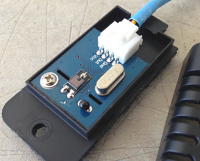

DHT sensor’s plastic housing is clamshell with friction fit. It splits in half with force applied at its seam. Wires coming with unit are terminal-attached to a circuit board that’s single-screwed into housing.
http://forums.pelicanparts.com/uploa...1487006194.JPG
Sensor board's bottom:
http://forums.pelicanparts.com/uploa...1487006327.jpg

Pin rack fault - Pin racks were added to Arduino to allow female plug-in terminal connections. Each pin can be pushed through rack if desired, also if not desired. Got system running and power began fluttering then... OFF completely. Found power pin rack being at fault. Changed rack to more solidly fixed pins.
http://forums.pelicanparts.com/uploa...1498858752.JPG
Faulty pin rack as just removed. Longer pins go into Arduino.
