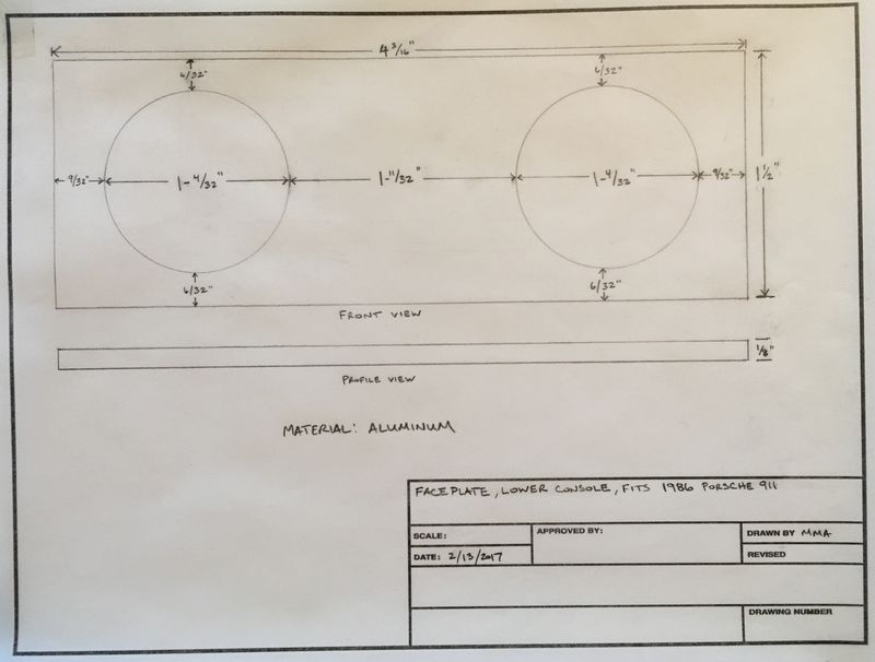

Privateer383 05-17-2017 03:40 PM
http://forums.pelicanparts.com/uploa...1495060474.JPG
Here is my USB socket attempt with my 1986 Targa, which turned out pretty well.
The USB and 12v power socket I used are, I think, from the same manufacturer as the ones posted by BERGO on 1/18/17.
The blue foam behind the face plate, and into which the back of the usb/12v sockets are placed, are water noodles from WalMart ($.96 for a 6 ft noodle).
I had a machine shop create a faceplate for me according to a wooden template I gave them, then took all the measurement and drew up the draft you see here.
Primed and painted and installed. No drilling required. Spliced into some power from the other wires behind the console.
