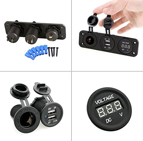

I was thinking something like this for the slot where the speaker fader is - but everything I've seen is a little too fat.
Dual Port 12V USB Charger Socket Voltage Voltmeter Rocker Switch Panel Boat Car | eBay

this looks interesting: https://www.amazon.ca/Multifunction-Voltmeter-Socket-Suitable-Motorcycle/dp/B00Y09N8T2/ref=sr_1_8?ie=UTF8&qid=1484759358&sr=8-8&keywords=switch+panel+usb+volt+meter
will order this as well:
EDIT: ordered it, cheap enough to give it a try. Looks like I can either use the panel it came with, or replace the existing lighter with one of the inserts (or add more elsewhere)
