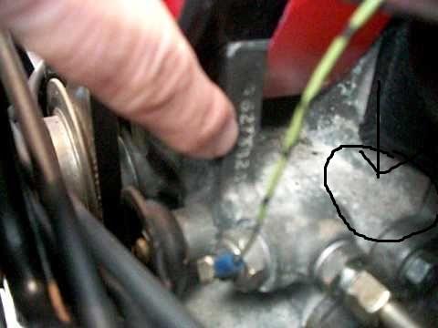

Posts: 7,433
Hi Sylvester
here and the circle.
and here in the specs..

that's the whole problem. no numbers on that case. someone change that piece.
