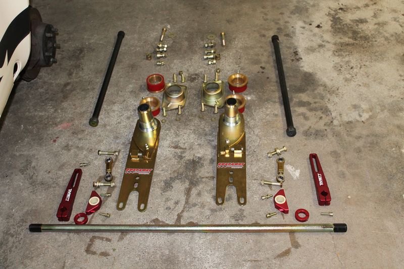

Zinc plating - is this "correct"
I've been going through my '85 Carrera refreshing suspension and other areas where I can easily unbolt, clean and/or have parts re-plated. I've found a shop locally that can do the zinc plating and is quite cost effective. The results are great for smaller parts in terms of the look, very consistent color without a lot of variation. But for the larger parts doesn't quite duplicate the factory appearance, there is some inconsistency and may be a bit lighter than the original finish. I've been told that my '85 had zinc plated parts, not Cadmium that was used on the earlier cars, although I could not find any information on when that switch was made.
I'm not building a show car, but would like to understand the "authenticity" of what I am doing to the car, and get any opinions on whether the work of my plating shop is acceptable. Photos attached for discussion.

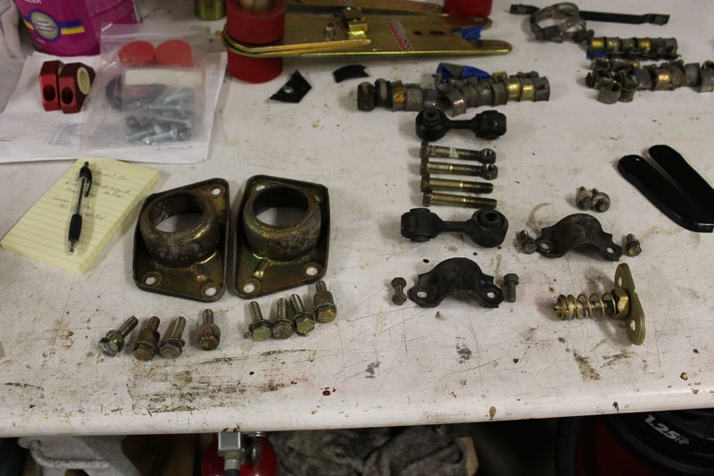

One more photo of the spring plates before re-plating. I didn't reinstall these on the car as I switched over to the Sway-Away adjustable units.

It sure looks nice and correct by the way - could be yellow zinc / zinc chromate.
You can check me but our cars were in fact CAD plated, and while some places may still do it, I believe it was generally stopped due to the toxicity of the process. The yellow zinc is safer and just as nice.

Your color looks great. There is plenty of shade variation on factory finishes and yours fit well in the range. Besides, the suspension parts will get darker due to use in a few thousand miles anyhow...

Only the smallest amount of clear cadmium was used on SWB cars, anything yellow on a 911 has always been yellow zinc.

Thanks, I didn't know that yellow Zinc was the plating all along, feel much better about spending all the time and energy to get as far as I have. Interesting to hear that they will darken up over time as well. If you are in the SF South Bay area Valley Plating in Santa Clara did the work. All of the parts in the photos plus a bunch of smaller bolts, nuts and washers cost $100 with a three day turnaround.
Here's a shot of the suspension before I put it all back in the car. Need to get going on the front end next.
