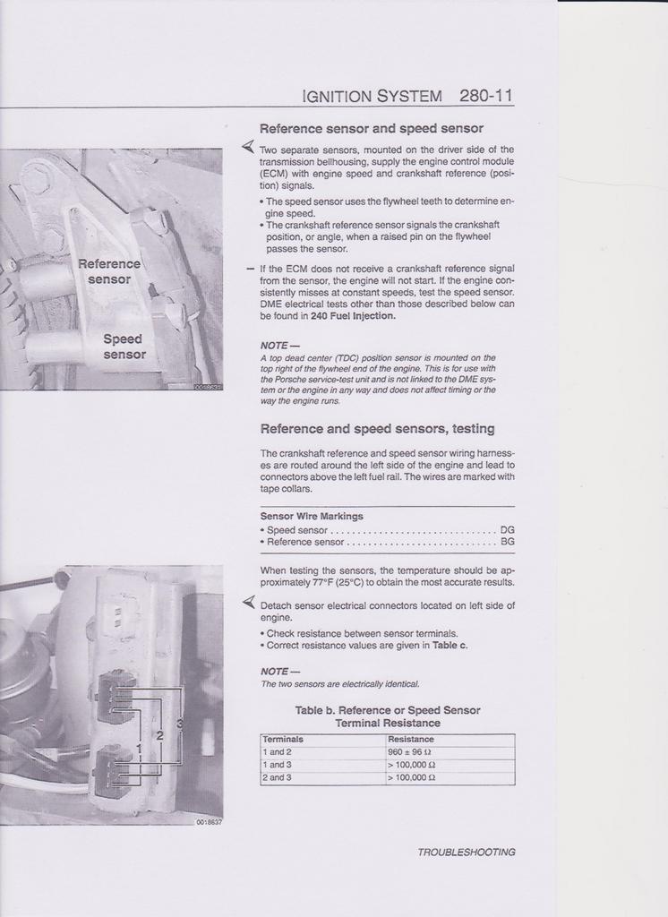

There are three connectors at the back left of the engine. The top white one is broken, so I need a new one, but cannot work out what it does or what the part number is...
I have zippy tied it together for now but need a new plug.
Anyone know what those three connectors hook up to or even the part number? Thanks in advance.

hi there....
the search button on top right should give you plenty of answers...for now here is some
Ivan
and here
Head Temperature Sensor Replacement
and some reading
https://rennlist.com/forums/911-forum/615361-reference-sensor-gap.html

The strapped connector is head temp sensor.

Excellent gentlemen. Thanks for the quick replies. Another job on the to do list... would Bosch sell only the connector? My wiring is fine, just the connector male part is broken...

The male side (the yellowish part) is part of the head temp sensor, not replaceable separately.
206 637 4071

Is the female side connection available somewhere? Mine is broken too, but on the wiring harness female side and rigged similar to the OP's picture.

Here is one Parts source. They're called Junior Timer Connectors (ancient name).
AMP Connectors/Terminals
