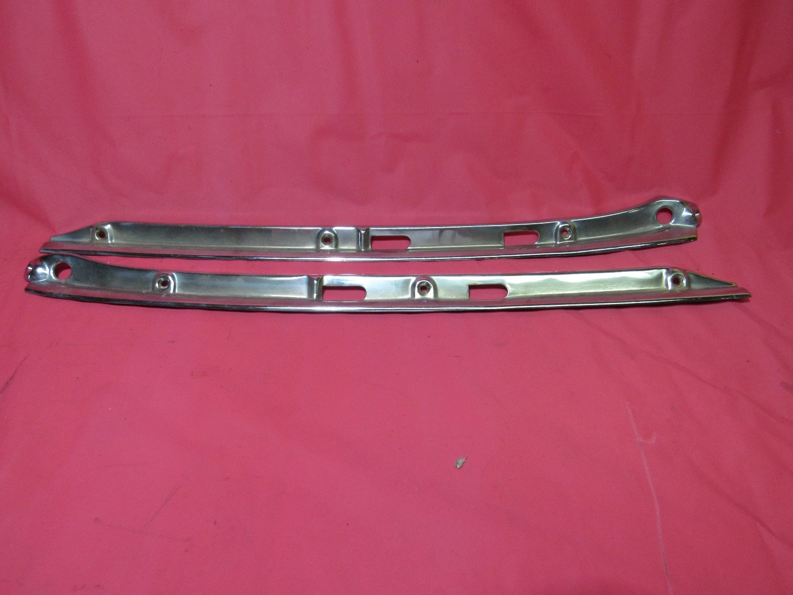

I checked everywhere but can’t find this part #
Howdy Pelicans,
Can anyone tell me where I can find the parts diagram or part number for these? They go on top of the windshield frame of a cab. I’m actually looking for the screws as I’m in the process of reassembling.

I am thinking these are the parts, # 3, L & R (though the reference is for Targas). My car is an '87 and this is the PET I have. See the part numbers for the screws, #s 5 & 6, here: N 013 957 5, and 900 144 009 00

The strips above are the trim under the seal for the rear glass. The black trim for the windshield frame are #40 911.555.559.60 and 911.555.560.60
The black screws #41 to attach it are 900.145.071.07
