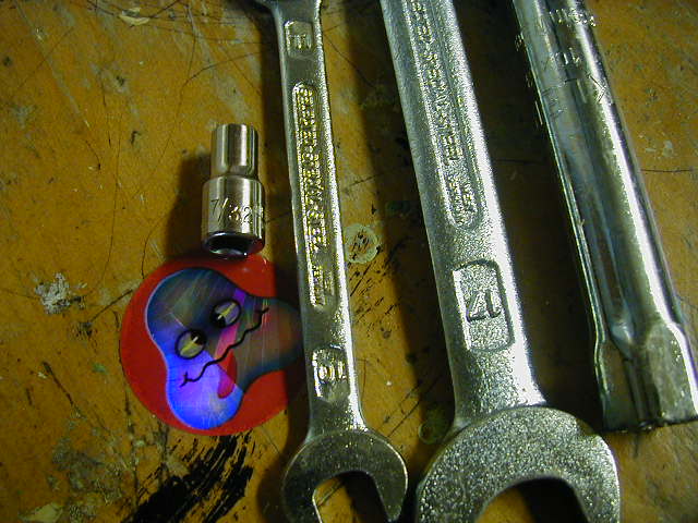

Mine was loose and it took a 7/32 to tighten it down. If it is loose the contact tabs inside the unit will short out against the housing. I blew a 25A fuse finding out. Tighten it up finger tight! Very important!

Besides a wire cutter and crimper these were all the tool required. And they are all in your Porsche tool pouch.

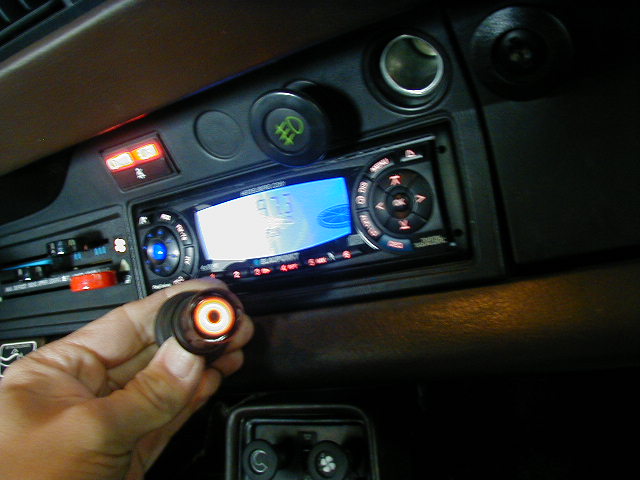

Jason2guy - The color of the car is a light gold. Some call it Champagne? Otherwise, see the pic for more detail.
