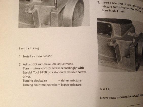

and here you most likely have this plug still in .If not you just have to adjust it .If the plug is in you have to remove the AFM unit and remove the plug to access the adjusting screw for fuel mix.
http://img.pccreation.net/photos/201803031656443009.JPG

I have owned the car for 10 years and have never touched it. There was no cap on it so I am assuming a PO has touched it.
How do I set 1.0? 1.0 what? Volts?
Are you now talking about mixture screw or idle screw??
I was talking about the mixture screw on the underside of the AFM.
proporsche 03-03-2018 06:59 AM
ok now i know you know which mix screw .To set it you have to go to someone who has the gas analiser .Or you can play with it by listening to your engine .It has to be warm to adjust...oxy sensor disconnected and side plug jumped with your tool-wire.
