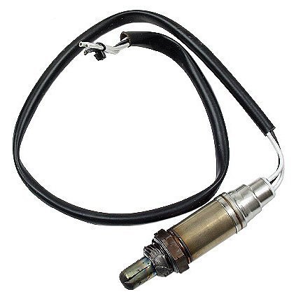

I just played with it. When I started it surged as per normal and then settled out quickly because the engine was still warm. Idled fine. Unplugged the O2 sensor. Idled fine.
I have a univeral 3 wire o2 sensor. I have the black wire going to the green wire. I am hoping this is correct and this is also the only wire I disconnected.
Correct me if I'm wrong but doesn't the car ignore the O2 sensor when it is cold?

.well the circuit goes trough the oxy sensor and fuel is corrected all the time.You have to disconnect all 3 wires for adjsuting the fuel mix and if you have a catalyst you should measure before cat.
I do not know what do you have as an universal oxy sensor .Maybe a picture? Basically there is no need to have it plugged in at all.In Canada you do not have a smog inspection or do you?
i suggest you go and check your fuel mix....
Bosch 3 wire universal 15726
Ivan
Is there an easy way to check mixture without having a gas analyser?
