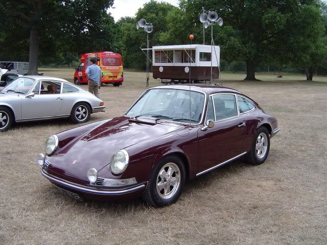

Here's mine still working it all these years later new project is adding the air con I picked up from a 65 car I have here. And still rebuilding my 125BHP 912 motor!!!
I to started a great into price of $2000 £1200 back in 1999 so you are the same as me.. what you spend on the car will still pay you back later on... nice one.
