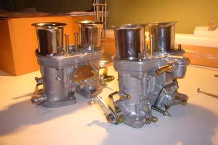

Rebuilt the carbs, and earlier problem of starving at top end has gone away. Something was blocked somewhere!
NOW-- when cruising at constant speed, the 1/2 carb growls so loud, it's brain rattling. Every once in a while it'll backfire out the carb too.
If I give it gas, the growl goes away... if I let off, the growl goes away. If I'm constant, it growls. It'll stop for 10-15 seconds, but then it's back.
IDF 40
32 vent
135 main
200 air
f11 tube
52 idle
3 psi fuel
1.25 turns out at sea level.
Linkage is synced at idle, downrod geometry is similar on each carb...
RPM wanders a hair (surging/stumbling) at constant speed though, and that growling!

Sounds like you have a combination of a timing and carburetor setup.
What you have described on your carbs is a VW setup that does not work at all on the Porsche.
Here is the common setup for the Porsche:
30-32 venturi
130 main
190 mid
55 idle
F7 emulsion tube.
I suggest that you do the following:
1. Adjust the valves
2. Adjust the timing @ 3000RPM to 30-32 degrees
3. let the timing at idle fall where it may.
4. Then adjust the idle speed to 950RPM using the idle speed screws.
5. Next adjust the mixture screws to the "best lean" for each throat.
What type of distributor are you using?
If you have a 009 replace it.
Let me know how you you are progressing because I fought a similar problem with mine.

I think it was just too lean... I opened it up to 2 turns out, and popping & backfiring has stopped (it popped once today actually). It smells a little rich at idle, so I'm gonna try the 50 jets I have in a jar somewhere...
Timing is good-- set with a digi tach/light.
It's much better now, and I don't think I'm going to mess with them until I get an 031. The 050 & new in box Empis came with the car.
After the 050, I need to do Struts, then maybe some Spanish Webers... I'll bookmark this, and use your setup as a starting point for those-- I live at sea level, right next to the ocean. Thanks!

The Empi's that you have out of the box are setup for VW's. I went with the Empi's and quickly learned the hard way that these are junk. The emulsion tubes F11 are totaly wrong for the Porsche. To get the Empi to work properly I had to go to 2+ turns on the mixture screws which resulted in a too rich mixture that caused backfires on deceleration. After about 6 months of this nightmare I got a set of new Webers from Webers Direct, rejetted them and they run perfect from sea level to 8000 ft elevation.

Out of the box, those carbs had smaller vents & smaller jets. I got the bigger vents and a jet assortment with them too. PO never got to it. He had installed the carbs as purchased, then parked it, then I bought it.
He said he hadn't driven it & I believed him-- ran like crap! Although they looked new, filters and all, I opened them up & they were DIRTY! Floats were all over the place, etc. Still had some hiccups, so I went through them again. A little fiddling & much better now.
They're running well enough I can leave them alone & do other things first. I'll get to CB upgraded Spaniards later.

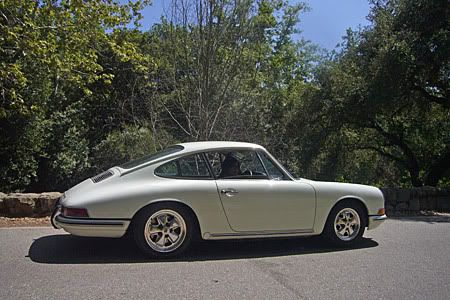

Great Looking car!! You can be proud of that find. Where are you located? I live in Hemet, CA 29 miles west of Palm Springs at 1800 ft elevation. I have all the elements 100+ degrees in the summer to 40 degrees in the winter. I go to all the club meetings in Orange county at sea level to 8000 ft at Lake Arrowhead.
I had a nightmare of a problem with the Empi's because the adjustments do not remain consistent. I took it to a Porsche Weber Guru and we put on the dyno and plotted the flows. The results indicated a change. The velocity stacks were also wrong. The popping thru the carbs (lean pop) even burned my K&N air filters. Lucky I didn't have a fire. When we richened the mixture to stop the popping it fouled the plugs and started backfiring on deceleration.
The new Webers solved the problem.

J11, Another thing to get rid of are those stacks. They are only good for looks and if you are going to do SCCA racing. However for normal street driving and racing you do not want them. Your low and mid range acceleration up to about 5800rpms will be much better with out them. Anything over 6000-8000rpms the stacks will become useful.
If you have a good 031 it is the best distributor for the 912. The RSR0012 is just about as good. The RS didn't do as well with my setup as the 031. So I am really particle to the 031. Once you have the Webers and distributor sorted it out. You shouldn't have to mess with them for a long while. Just check the sync once in a while. I have almost 16000 KM since I finished with my set up. All I have had to do was just check them once a year. I have never had to readjust anything. However, I am using the Pertronix in the distributor along with the coil and CD box.

Good to see you on the board! I agree with your assessment. I use the RSR0012 because my old 031 was shot. I converted to the Pertronix also and all my timing problems went away. When I purchased the new Webers they came with the typical VW setup including those stacks and a cheap fliter base. I replaced the filter assemblies with the Weber machined aluminum base #3377 from CB Performance Products. I replaced the velocity stacks with the shorter Weber stacks and K&N airfilters.

I have a set of those CB Aluminum bases, and when I went to put them on, the studs were a hair short-- just a hair. Removing the velocity stacks would actually be enough to make the lock nuts work!
No stacks + back to the CB bases. Check.
