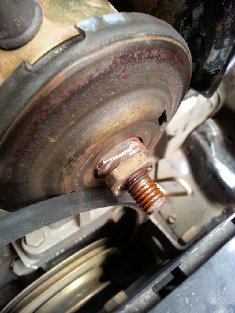

Old 06-20-2016, 10:23 PM
Join Date: Feb 2014
Posts: 67
Hey guys
I'm back after ages, but i've been away and didn't have any tools at the storage space where the car is.
Anyway, i polarized the generator as per your instructions and all went well.
However, I noted that the generator seems to have been treated to someones mechanical douchebaggery at some point in the past :
So despite it turning round upon polarizing, looks like its crapped ?
Joseph
• 1967 Light Ivory 912 •
