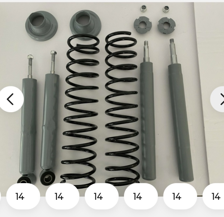

This Boge set on Ebay appears to have much smaller rear coil springs.

That oil cooler is aftermarket, definitely KYB shocks, aka kill your back.
Boge was standard, I think you could get Koni as an upgrade. I think Bilstein is probably the best overall choice. If I remember right, they do not fit interchangeably, Boge insert for a Boge shock, Koni insert for Koni shock etc

What additional parts would I need to install these Boge shocks?

That looks like a great kit for your needs. I once had kyb - kill your back shocks on my car. I hated the ride. Stock Boge should give you what you are looking for. You can also play with the tire pressure. Unfortunately, most tires these days are designed around heavier cars. Dropping a couple psi can really help.

After looking further this whole set is probably what I need at least for the front end. The set I posted above probably does not have all the parts I need. Can anyone confirm?

No, you don’t need replacement struts just to use oem style Boge inserts.

I went with that Boge factory strut set and am very pleased with the ride. Your struts are 4 bolt so they are factory and the Boge kit should be all you need. If you're looking for factory ride I wouldn't waste the extra money on Konis. If it were my car i would install the Boge's all around, (the included correct springs will set the rear back to factory ride height) re-set the front height via torsion bar adjusters, source a factory 15mm sway bar (which will bolt right up) and call it a day. But as others have said, to be sure just remove one of the front inserts to confirm what you have.
