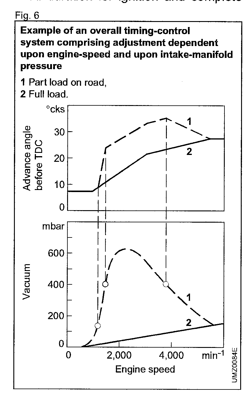

73, I think you're right. Here are the charts from the Bosch Ignition Technical Guide:
OK, this is pretty complicated, so here we go...
The two lines on the bottom graph correspond to (1) part load (partially closed throttle) and (2) full load (WOT). Under full load, manifold vacuum is low at all engine speeds and never exceeds the vacuum threshold where the vacuum advance mechanism is activated. Therefore, the advance curve is solely determined by the mechanical advance (curve 2 on the top graph).
For the particular case of part load shown here, the throttle is partially closed and engine vacuum peaks at some particular engine speed, which depends on the part load level and the breathing characteristics of the motor. In this case, the peak is a bit over 2000 rpm. When the vacuum reaches the onset level for vacuum advance (first circle at about 1000 rpm), the vac advance mechanism is activated and begins to increase the advance as the vacuum builds. At the second circle, the advance mechanism reaches its mechanical stop, and the total advance is equal to the max vacuum advance plus the mechanical advance as a function of engine speed (line 1 on the top graph).
As engine speed increases at part load, vacuum begins to decrease because the throttle needs to be opened more. Eventually the vacuum drops back to the region where the advance mechanism isn't up on the limit stop, and it begins to decrease (third circle). Eventually, to get the engine to attain near maximum speed, the throttle is nearly full open, and vacuum drops below the onset level, and you end up back on the mechanical advance curve.
For a 2.0L 914, the onset level is about 100 mm Hg, and maximum advance of about 7 deg. is reached at about 150 mm Hg. As 73 says, these levels are likely to be reached during the setting of the advance at 3500 rpm, and the vac advance definitely should be disconnected.

I've wondered about this. The effect is significant, over 10 deg. on the 1.7L's and about 7 deg or so on the 2.0L, and active across a fairly large range of load and engine speeds. The Bosch Ignition guide states the need for vacuum advance is that the air-fuel mixture at a lower load (i.e. higher manifold vacuum) is less dense and burns more slowly, requiring additional advance for optimal combustion.
I'd suspect that the real reason the advance is disconnected on later motors (and that the vac advance port on the throttle body is missing) is that more advance results in higher NOx and HC emissions, so they removed it on the later motors that had stricter emissions requirements.
It would be interesting to see the dyno curves of a motor with and without vac advance active. I'd suspect that the one with advance would have fatter mid-speed torque and lower fuel consumption.

Look on page 10 and you can see the problem. Advanced timing gives you the best fuel economy and torque, up to the point where you get predetonation (knock). However, more advance causes higher NOx and HC. Higher HC is caused by lack of secondary reactions due to lower exhaust gas temperatures, and higher NOx is caused by higher combution chamber temperatures - seems kind of contrary, but that's what the guide says (see p. 11).
If you have the later-style TB, you might gain part-load torque by converting to a '73 TB and using vacuum advance, at the expense of emissions.
