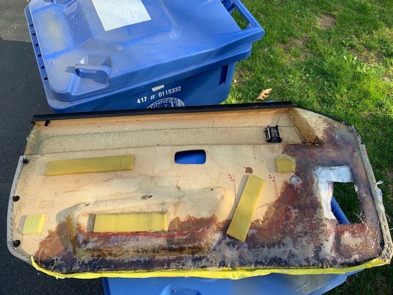

From the desk of promising to show mistakes and well as successes, sorrows as well as joys (for my Quaker friends), here's something I did this week which didn't work.
As SecondChris noted, this car could soon be registered (one hopes) and driven. That said, I still don't have all the interior back in (I have special plans), not even the door cards. They include the power window switches, and a couple of weekends ago when I moved the car outside - under its own steam - the inability to lower the windows bothered me.
The door cards are made of ... like the dash ... something akin to cardboard. At 35 years of age, they are fragile, so I didn't want to pull the switches and use them loose until I'd recolored the cards' vinyl. No, I'd need to get the door cards completed, and installed, the right way, the first time.
But ... there was some age-related damaged to repair first. On the driver's panel, the area where the door handle is attached was damaged and required a repair, as did a screw hole on the upper rear edge.
And ... the passenger door card was in worse shape, with its lower two inches of pressed-board thoroughly compromised due to it obvioulsy having suffered from wet/dampness over the years, an issue created by a former repairman obvioulsy having been inside the door (window regulator? door handle linkage?) and NOT REPLACING the membrane seal, aka shower curtain.
This is where I executed a repair which didn't work: I figured I could add strength back into those limp areas with some resin and fiberglass cloth, without removing the door card's vinyl and foam of from pressed-board. The vinyl is incredibly fragile. A good plan? No.
Why? The resin soaked right through the pressed-board and onto the vinyl; the ensuing chemical reaction left the vinyl warped and unsightly. My repairs to the driver's door, repairing pressed-board that was cracked but not water damaged, seem to not have allowed the resin to soak through, and were a success.
I've ordered a replacement passenger door card from Plyhammer. And BTW, the membrane seals/shower curtains appear to be available from Porsche AG; I think the number is 944 555 178 05, at approximately $35 each. I likely make my own and retain them with 3M strip caulk.

I'd applied resin and cloth to this whole area; it was thoroughly damaged from prior water ingress, but ...
... the chemical reaction between resin and vinyl resulted in an unusable panel.
Replacement panel is on the way.

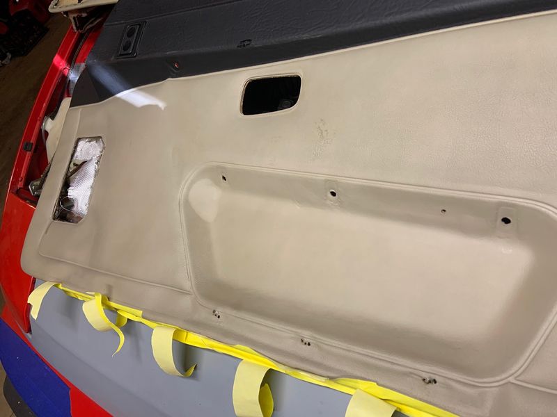

Nothing particularly interesting, just a little detail work today in creating the door membranes, aka shower curtains. I did this by scrounging up a good plastic bag of suitable thickness, my long-service box of 3M Strip Caulk and a fresh blade in the Exacto knife.
I remember when I was a field rep for one of the Japanese auto manufacturers in the early 90's and - uncharacteristically - most examples of a certain models had a water-leak problem due to a production error. The fix was ... installing extra, ad-hoc shower curtains under the door cards and around the speakers. They worked!
The original water damage to my 924S's right door card would have been averted had whichever tech was in here before me replaced the membrane seal, so I wanted to ensure that mistake wasn't repeated.
Reasonably strong but not overly thick plastic sheet sourced from a bag; 3M Strip Caulk and some black duct tape where I'd had to make a cut for the door handle Borden cable. I reused the foam padding around the door handle.
The right side door still had the individual membrabe to protect the speaker.
The left door was lacking both the speaker membrane and the foam around the door handle, so I replicated both
By using the strip caulk, if/when I or anyone else has to go back into the door's gubbins for some future repair, I/they should be able to carefully peel back this plastic sheeting and restick it once whatever we're working on is resolved, protecting the fragile door cards and eliminating water leaks ... at least through the doors.
