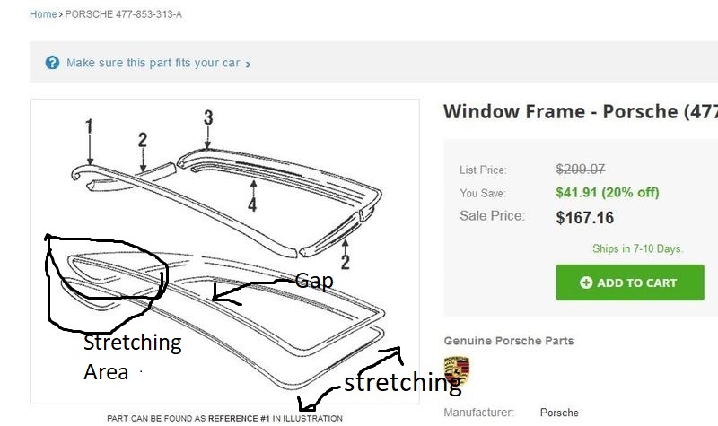

I think reinforcing the hatch frame along the side where the stretching and bend is would be the answer. I apologize for he rough image.

it seems that the shocks are putting about 40 pounds pressure on the bottom of the hatch and trying to shift it towards the license plate and if the bond to the glass is good there, well after 35 years or so, the metal frame there may grow but the glass is dimensionally stable so it cant' grow and pulls out from the frame at the top. twisting and so forth may help the frame grow.
I think that makes sense in my mind but i haven't yet dealt with issues with this, maybe others who have know more about it.
