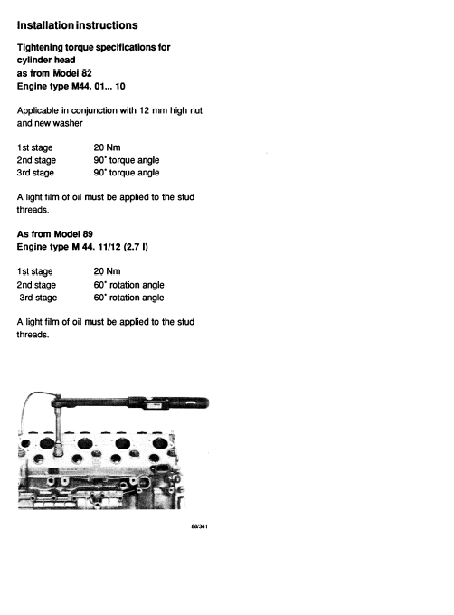

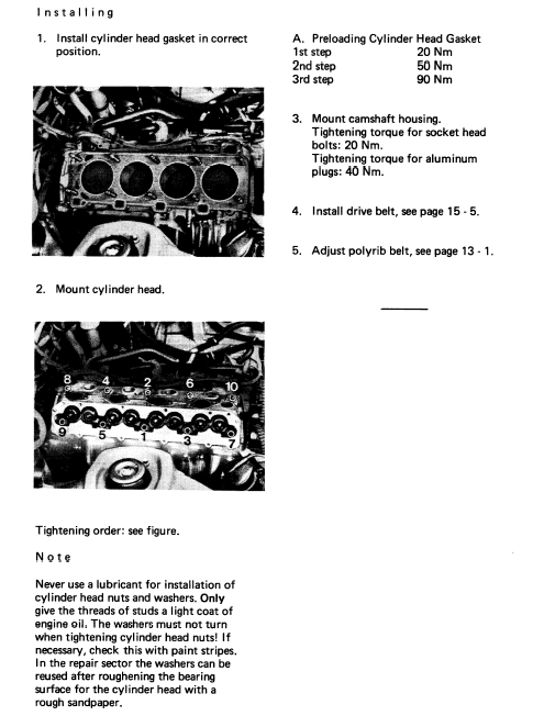

head specs
I was searching the site and i had trouble locating the torque specs for the cylendar head on an 86 n/a. Any help would be appriciated.

Here you go - follow the torque angle method for tightening, but follow the directions for which bolts to tighten first.
