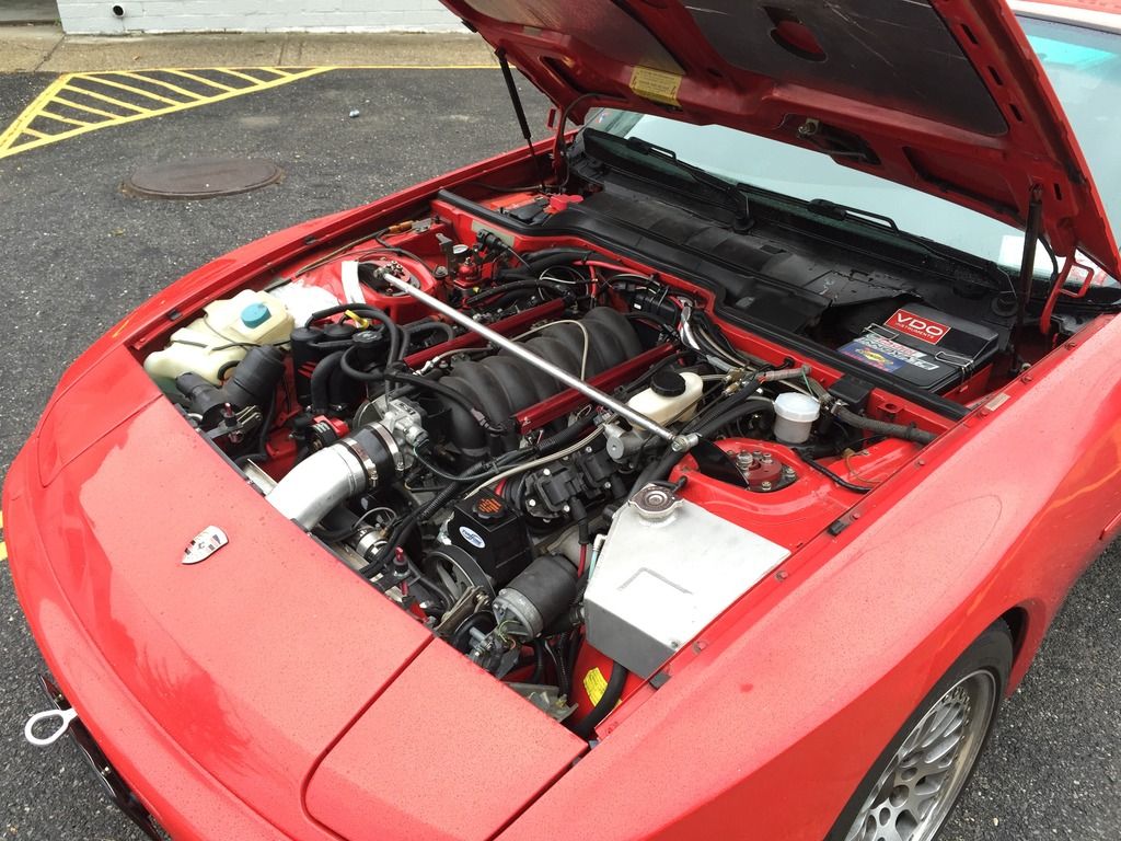

The Ford hydroboost works ok. My main complaint with it is the Ford Mustang master cylinder bore is too large which makes the pedal stroke very short. It just takes some getting used to. A guy on the 944Hybrid forum made an adapter to put the original 944 master cylinder on the Ford Hydroboost, this is probably the best method as you not only maintain brake bias front to rear but also dont change the pedal stroke.
Fitment is very tight but it works. Just need to relocate the two rear most coils.

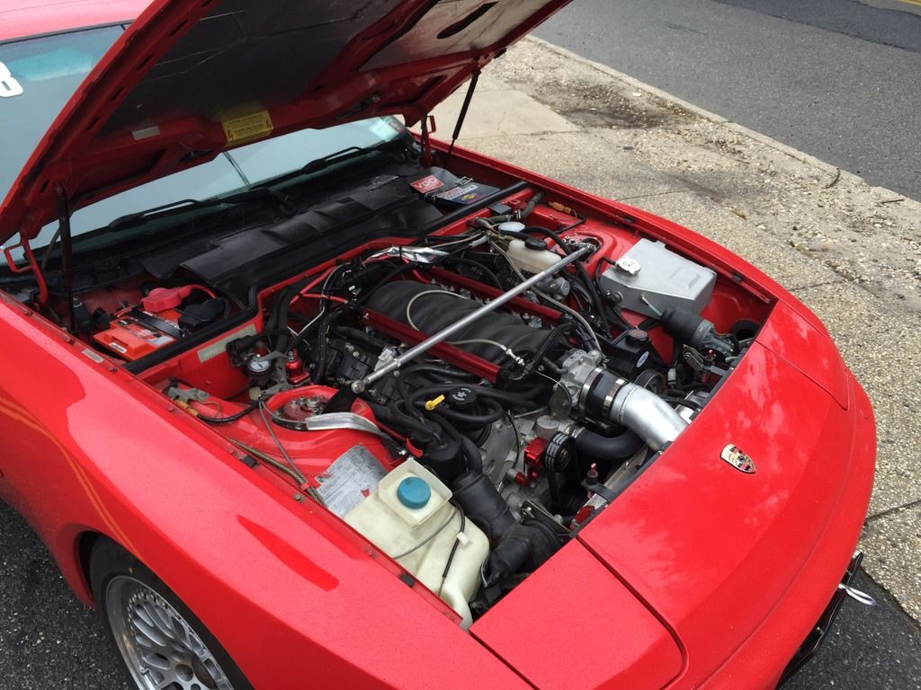

[IMG][/IMG]
Old picture but the only one I have. This has been my daily driver for 3 years. The car has manual brakes and a sport manual steering rack. The one mistake I made was to start driving before finishing the A/C. I still have not done that and it has been 100degrees or over all month down here.
The brakes are a dual MC set up. I think the brakes work really well other than needing a heat shield for the lower MC. During extended stop and go driving or after shutting down the lower MC fluid boils, increasing the pedal travel until it cools/clears air and the pedal comes back. As said above the best solution is hydroboost and adapter for the proper MC.
Wow that sounds safe, at least you have a V8, priorities I suppose.

I made it sound worse than it is. The manual brakes have much less pedal travel than the power brakes even when the lower MC is hot. Nothing a higher boiling point brake fluid won't fix.
