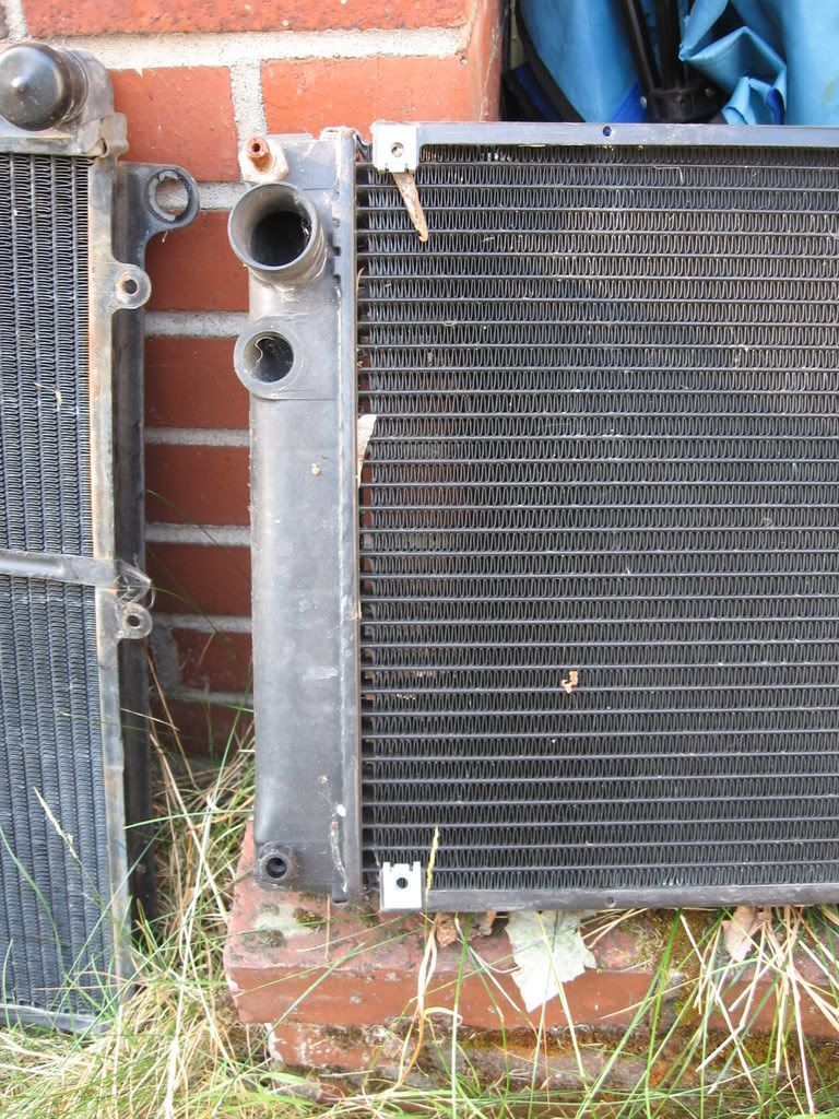

Okay, I'm getting ready to change my thermostat in the hopes it will cure my over-heating issue. I have the front wheels up on ramps, dropped the belly pan and am ready to start draining the colling system.
I know there is a plug on the engine block, between 3rd and 4th cylinders. Looks like a pain to get to, so I think I'll be popping off the lower end of the lower radiator hose instead. (I've read that should do the trick as well as the engine block plug.)
My question is regarding the location of the radiator drain plug. Everything I've read indicates the plug is made of plastic and is located on the lower, driver's side of the radiator. (Lower-left side, if looking towards the front)

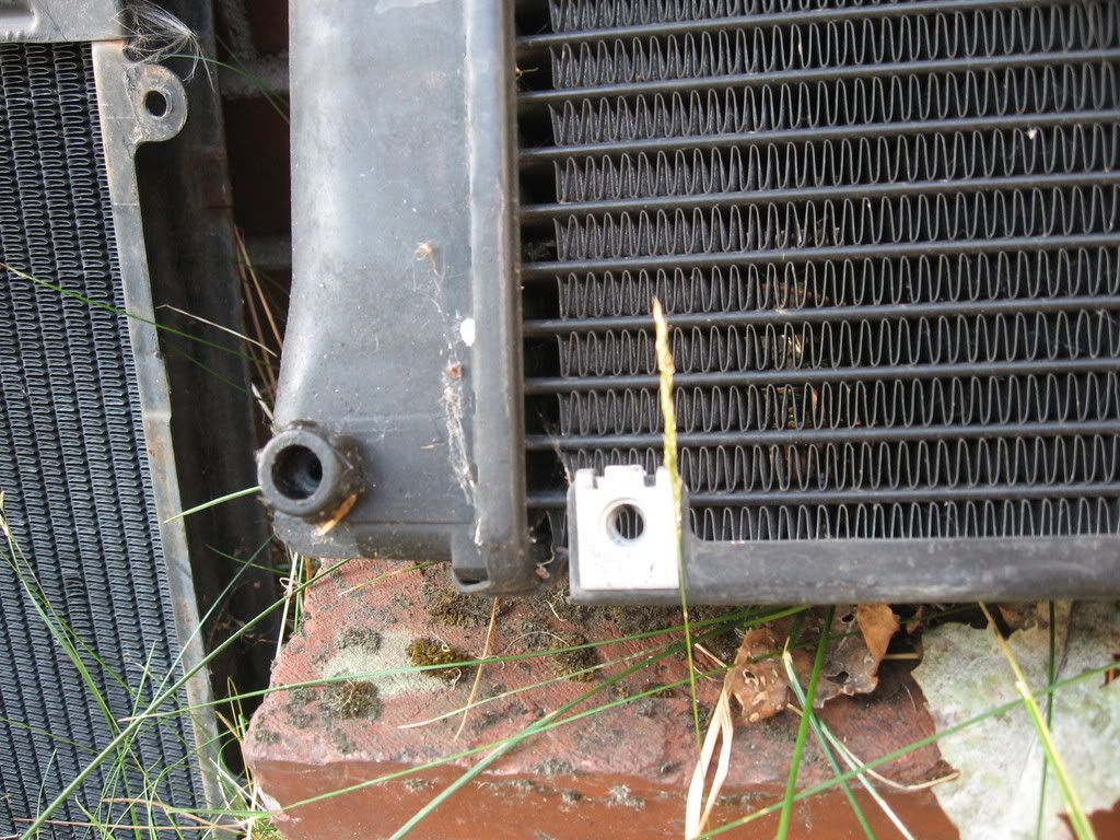

the only thing I've been able to locate that looks as though it could be the plug, on MY radiator, seems to be a 19mm plug that seems to be made of brass. Below is a drawing of where I'm seeing this "plug". Can anyone confirm this to be correct?
Thanks!

On a '44 I believe the drain is covered by bodywork. . .even if you get it out it will go everywhere, you may be better off just pulling the hose.

Thanks! That appears to be the same location as the plug I'm looking at. I'll confirm when I get home this everning and will post an actual photo from the car.
Interestingly, there is "nothing" in front of this plug. Looks as though it will come right off and the coolant should flow right out, into a waiting bucket. Again, I'll confirm I'm looking at the correct item and will post a good pic of my own.

I would personally remove the lower radiator hose instead of the drain plug. Those plugs become pretty brittle and there is a good possibility it will break off. Atleast have a spare ready if you do use this method.

I'd leave it alone too, stock, those plugs are plastic, and will break easily. I drained my radiator that way to replace a faulty thermoswitch, and ended up snapping the head off the plug when I put it back in.
If it's not blue plastic, then someone just used a different (and probably sturdier) bolt in the hole after they broke the original.
I'm actually a little concerned about the idea that a dis-similar metal plug may have been used. From what I've read, this can be a really good source for corrosion throughout the radiator. Hmmmm...!

Okay, this is the best I can do with the pic. This is a view, from right in front of the driver's side front tire, looking forward, at the radiator. The plug is located in the lower left-hand corner, as indicated in my drawing above. Does this look about right?

The best way to drain the radiator is to remove the lower hose on the passenger side of the radiator. Are you sure the thermostat is causing the problem? What symptons are you seeing? I put a brand new thermostat in, along with a new German Laso water pump when I did the top end job. I also flushed out the radiator even though it was very clean. Have you checked the fan circuits and made sure there is absolutely no air in the system? What about the connections and grounds for the temp sender and temp gage? Did you tap on the face of the gage to make sure the needle is not sticking? Just some ideas before you start wrestling with that PITA thermosat retaining clip.
