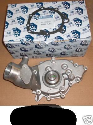

Today, I experienced an emotion, which I can honestly say that I have never associated with my 944 before; I honestly considered leaving parked, with the keys in the ignition, in the hope that someone would steal / wreck / burn it.
I guess it's just been a long slog and just when I think I'm seeing light at the end of the tunnel, it turns out to be some b'std with a torch, bringing me yet more work to do!!!
Having spent months doing a thorough belt job (both belts, all tensioners, all seals, water pump, thermostat) I finally got the car running again on Christmas Eve. After a short road test, it was clear that it was running fine - just overheating.
Initially, I attributed this to an air lock - so a week of adding coolant and bleeding followed - to no avail!!
Having noticed all the signs of a failed thermostat (hot engine, cold radiator) I resolved to replace the aftermarket part that I fitted with the new pump, using a genuine Porsche part.
So, last week, I got to it. After a struggle getting the snap ring out (why didn't I fit it with the tabs at 12 o-clock!!) the new Porsche part slotted in beautifully.
With the system filled and bled, all seemed good. At idle, the fan cut in with the tep guage at the 3/4 mark and cooled it quickly to the 1/4 mark.
All was good until the test drive - fine for half an hour or so, but then gradually crept up to the red area.
On returning home, I noticed that the fan was not running, so, today, I slotted in a brand new OE Thermoswitch. Again, on the driveway, all was good - heated to 3/4, fan kicks in - cools to about 1/4.
And, again, all was good until the test drive. Admittedly, it took a little longer, but the temp hovered around 3/4 throughout the drive and then hit red as I was reversing back onto my drive. Again, when I parked, the fan was not running (at least, not at the half-speed setting - with the engine off, but ignition on). It should have been - because the temp was into the red.
It strikes me that I have one of the following issues:
(1) The aftermarket water pump is not up to the job - the car never did this before the water pump job. For reference, I have used one of these: http://cgi.ebay.com/ebaymotors/NEW-PORSCHE-944-944S-S-924-924S-S-WATER-PUMP-W-GASKET_W0QQcmdZViewItemQQ_trksidZp3286Q2em63Q2el11 77QQhashZitem140278766075QQitemZ140278766075QQptZM otorsQ5fCarQ5fTruckQ5fPartsQ5fAccessories
(2) A possible issue with the fan relay
(3) Maybe the cooling system suffered some sort of issue, whilst it was empty for about a month - during the long-term belt job
(4) Of course, it could just be the temperature sender
(5) Possibly a blocked rad - although, having flushed this with a hose, it seems to run freely enough.
I must admit that I'm at the end of my tether with this (and, I have a really slow fuse!).
I'd really appreciate any words of wisdom, or shared experience, which anyone else has had with this sort of issue.
Oh, and now the car has started trying to kill me on wet roundabouts - during the test drive today, entered a wet roundabout at about 20 (which didn't feel fast) and found myself looking back the way that I had come from - so now I have a nice front air dam repair to do also.
Where's the petrol and the matches!!!!!!

Im not sure if its possible to reverse the leads on the fan. The pre '85 cars simply have a fan switch with spade connectors on it, the newer post '85 fan switch has a molex connector instead. Im not sure what effect would reversing the leads on that be, but i dont think that would make a difference at all. All the fan switch does is complete the circuit, so it shouldnt make any difference.
The fact you say the temperature slowly rises up tells me air is not your issue. Also since you have heat, that is a good indication also. If the cooling system was airbound you would typically see normal temps, then the a sudden almost immediate spike on the gauge.
I would say double check the temperature gauge is reading correctly, from your description i would say it is, but its worth a shot at checking and its easy to do. Honestly i do not believe this is a gauge issue, grounding issues usually cause erratic gauge readings and you seem to have fairly consistent readings. Or atleast you do not mention erratic readings.
I think its possible the waterpump pulley is slipping on the shaft. This is possible with rebuilt pumps and from the picture it looks to be this is rebuilt pump. I say that because this pump casing does not have the turbo water fitting on the front end. All of the new pumps are superseded to the newer style turbo pump, n/a's simply use a blockoff plate in this location. You can check this by removing the front timing cover and making with a paint pen or white out (whatever you have) the orientation of the pulley on the shaft. See the picture below, i put a green line where the pulley and the shaft meet. If you start the car up and get your overheating issue stop the car and check the marks are still lined up. If they are not, the pulley is slipping on the shaft, this can be corrected by putting a tack weld between the pulley and shaft. The other possible failure is the impeller falling off the shaft. But this does not sound like your issue because then the car would overheat pretty quickly.

Maybe the picture just doesn't show correctly, but my water pump gasket looks nothing like the one in the picture from the auction...is it just me? Doesn't look like the gasket extends to the upper exit cavity of the block.

You are right; the gasket supplied with the pump was (for some reason) only a partial gasket. I actually fitted the pump with the correct full gasket.
GREAT...that had me really concerned. though I couldn't imagine if someone didn't use the correct gasket that they would make it more than a mile or two before the motor would seize.
