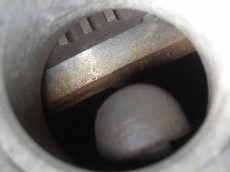

The sprocket notch does indeed line up when the cam gear is at TDC, however the line doesn't match up on the flywheel, in fact... there is no "OT" at all. I went under the car and checked the opening near the starter. With the sprocket and cam gear lined up here is what I see.

MakeshftPatriot 02-06-2009 10:56 AM
I found the other hole right by the starter, unfortunately I cannot locate any sort of notch whatsoever with the sprockets and cam gear lined up.
I have never installed a flywheel before, and I don't mean to sound silly but.. Could it be aftermarket? or on wrong?

Techno Duck 02-06-2009 11:07 AM
Hey, that is still not the correct spot to look for the notch. What you are looking through is the clutch inspection hole. I will upload a picture shortly of the spot i am talking about.

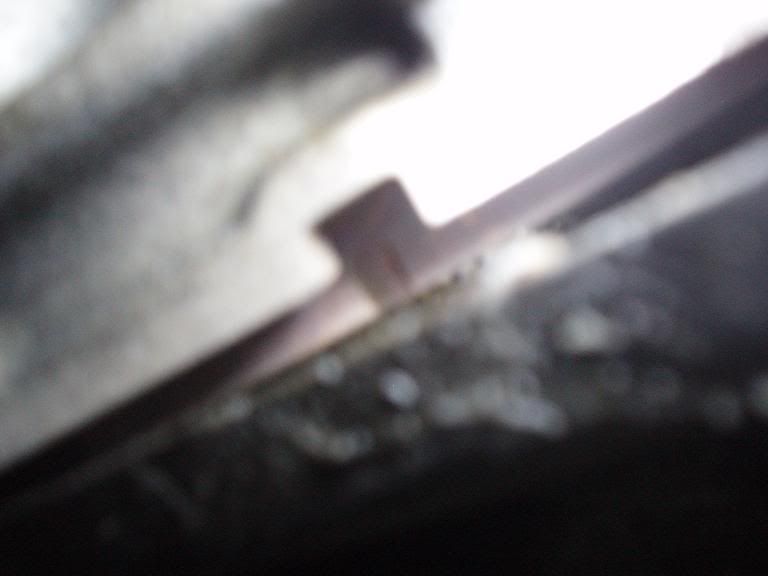

MakeshftPatriot 02-06-2009 12:21 PM
Thank you a ton Mike and Techno.
I set everything up to TDC and found the inspection hole with the notch clearly visible. But... the line on top of the flywheel does not match up, I'm extremely stumped. I can't even find the OT whatsoever no matter how much I turn it.
A poor picture, but the line is visible at TDC.
http://img.photobucket.com/albums/v4...t/P1010011.jpg
If the sprocket and cam gear line up shouldn't that mean its ok?
Is it at all possible that the flywheel was replaced perhaps put on wrong? It doesn't make sense at all to me. This seems harder than it should be, but I'm not willing to drop pretty pennies on a new head.

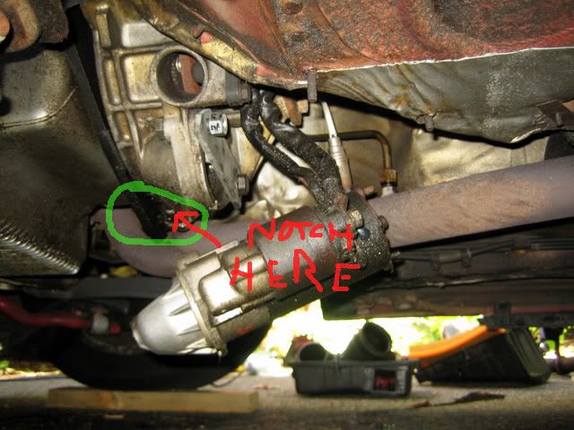

bazar01 02-06-2009 04:10 PM
You already found it here in your first photo. If you shine a light in the circled area, you should be able to see the OT mark.
http://forums.pelicanparts.com/uploa...1233965268.jpg
This is the OT mark on my previous S2.
http://forums.pelicanparts.com/uploa...1233965308.jpg
TibetanT 02-06-2009 05:35 PM
Couple notes from the Porsche Factory manuals with regard to TDC.
If the cam sprocket/pulley was changed out and aftermarket used as replacement, there are NO TDC marks. Manual instructs the mechanic to make new reference mark with scribe, pencil, or whatever and use the placement of the timing chains as they orient the cams properly. So, the cam/valve cover needs to be removed to see this.
Second, it appears from the Factory manuals that the S2 3.0L engine rotor setting is at 12:00 o'clock position. In other words, straight up. Then, look for OT mark on flywheel.
