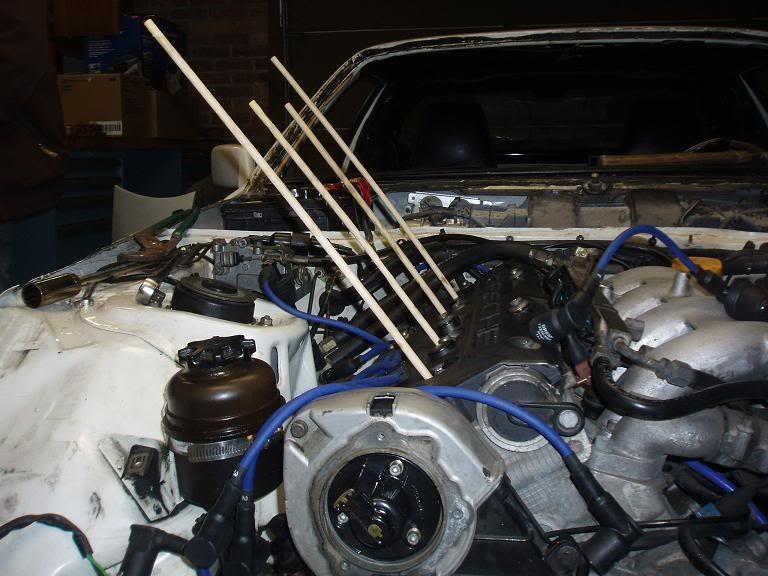

I have been rebuilding my car all winter since a previous accident. My distributor cap and rotor were crushed beyond recognition. I have since bought a whole new ignition system with rotor and cap, unfortunately there weren't enough remains of the rotor left to recognize what angle it was at.
I put the first cylinder as high as it can go and installed the rotor to where I believe it makes sense according to the firing order and distributor cap. I wanted to get feedback before I try and start it, if the rotor is off place, its grounds for disaster correct? I also have a feeling it needs to be one right of where its at.
Here is a picture, I hope you guys can help me get this right.

i think when at TDC the rotor should be pointing right/down side

At TDC, the rotor should point between the 4:00 and 5:00 position.
The best way to verify you are at the correct TDC and not on another stroke other than the start of intake is too remove the belt covers and line up the marks on the cam gear and cam cover. These should correspond with the OT mark on the flywheel.

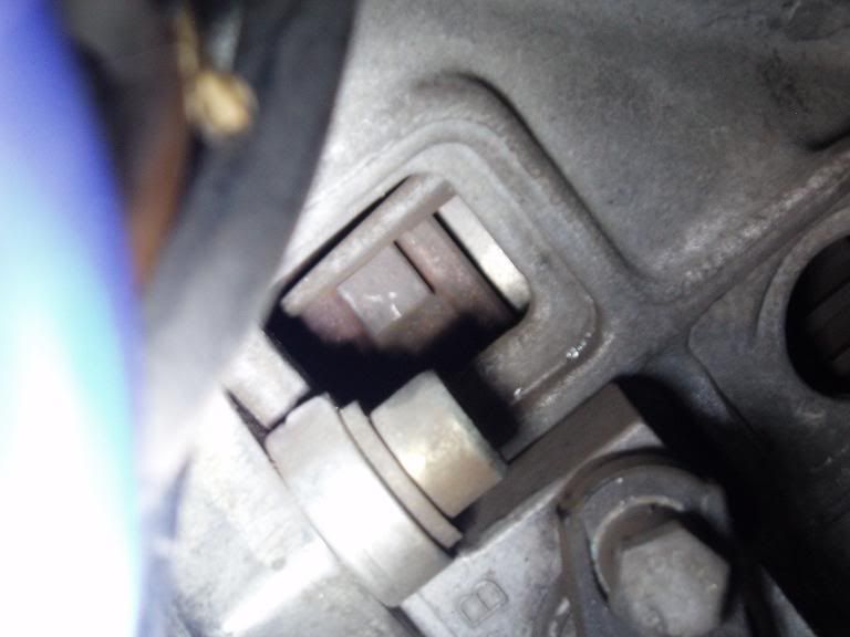

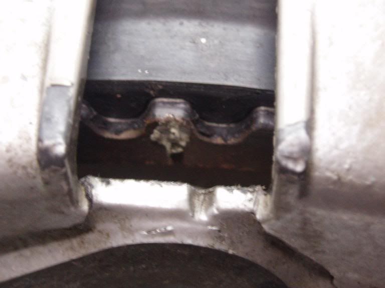

So I tried aligning it up today and here is what troubled me.
I line up the line on the cam gear with the window but I can't find the OT on the flywheel they describe in the article.
That's what I see, and if I turn it forward or back I cant find the OT at all. Guess I need to dig deeper.
EDIT: Found a line on the flywheel with out the OT, but the pistons do not appear to be at TDC at all.

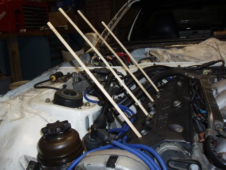

When the line is here (as close as I could get for a one man job).....
The pistons look like this when the line on the flywheel is centered, and the cam gear isn't lined up at all.
I didn't touch the belts at all, but could the accident made it jump teeth? Is my flywheel installed wrong haha?

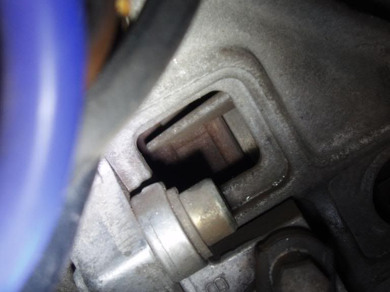

I lined up the cam gear as said in the article, and the rotor fit in between 3 and 4 o'clock like said but the flywheel alignment is way off. I have a hunch I'm probably missing something key in this equation, hopefully its a no-brainer.

When the mark in the flywheel window is in position, the mark on the camshaft gear should also line up.
I suppose if the impact suddenly mooshed the distributor/rotor - completely stopping it - then yeah, the force of the engine running could have stripped a few teeth off the belt. All of the engine torque would have suddenly been applied to the belt as the rotor abruptly stopped. That's a lot of force.
What was the engine doing when the impact occurred? Revving? Idling? Did it stop running immediately? If it was high RPM's when the impact happened, that'd mean even more torque to the belt.
You probably oughta pull the belt covers off and look. You can check the marks on your balance shaft pullies then as well - if the belt stripped/jumpped teeth, they will be off too.
If the marks do not all line up, I'd put on new belts - I wouldn't trust the old ones if they did slip/strip. Belts are cheap - head jobs are not.

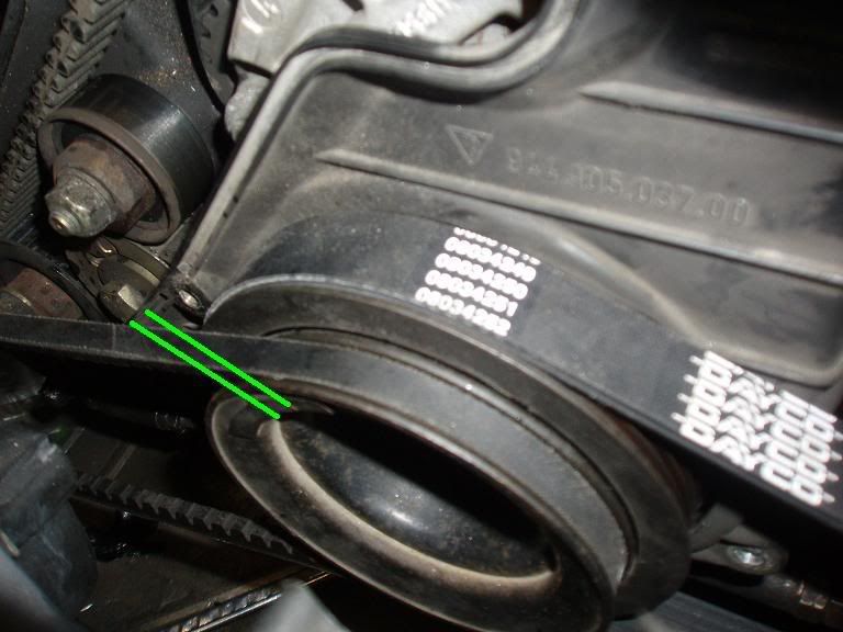

Mike, There is no damage whatsoever on the timing belt. When I have the cam gear set to TDC the lines on the crankshaft pulley point to the distributor. If I recall reading correctly that is where it should point? I was unclear by what you meant about lining the pulleys up.

I agree with Mike, take the belt covers off and line up everything at TDC based on the mark with the cam gear. The balance shaft sprockets have marks on them also that correspond with markings on the rear belt cover to designate TDC. Basically i want to see if the cam gear is still lined up correctly with the balance shafts. If they are, i dont think the belt slipped.
As for the flywheel markings, the line you took a picture of looks to be the correct one. The OT marking will be visible by turning the engine slightly CCW (only a few degrees) if looking at it from the front of the car. To verify if the flywheel is at TDC, there is a notch visible from under the car in an opening to the clutch housing, right by the starter. The notch on the flywheel should roughly lineup with the notch on the clutch housing.
BTW, i have some limited experience working on my friends 968 which uses the same style ignition rotor. Its been a while since i worked on it, but i am almost 100% sure the ignition rotor is basically keyed so it can only go on the cam gear one way. With what you said about the ignition rotor pointing in the 4:00 position with the cam gear at TDC and looking at the pictures, i think your crank and cam are out of time with eachother. This unfortunately means piston / valve collision may have occurred. I am very surprised the engine still ran if the cap and rotor were destroyed as you mentioned.

+1 what Jon said. Based on what you said about the distributor being smashed, I'm surprised the car ran at all.
I'm not sure what you're talking about with the green marks on the crank pulley.
The only 100% accurate way I am aware of to set the car OT is to use the window on the bellhousing just in back of the speed/ref sensors (I've read there is a inspection port on the flywheel somewhere down by the clutch slave where you can look but I've never used that).
The balance shaft sprockets have marks on them (small notches that look like "V's") which you line up with markers on the back belt case. Here's a picture of an icky looking lower balance shaft sprocket on an 84 NA:
Note the plastic marker tab on the case and the notch in the backside of the sprocket. I've never seen the guts of a 3.0 L but I'm guessing if this isn't exactly the same, then it's very close to what you have.
The upper balance shaft sprocket has the same thing. I don't remember what position the plastic marker tab is in on the upper BS,
When the crank is OT and the camshaft gear is lined up on it's mark, then the two BS sprockets must also be lined up on their markers.
If when the crank is lined up OT and the markers on the cam and BS's do not line up, then you've got problems.
You car ran until you turned it off and that's very encouraging.
If the marks do not all line up, then like I said, I'd re-do the belts - line up everything correctly and slap new belts on. Just to be safe.
